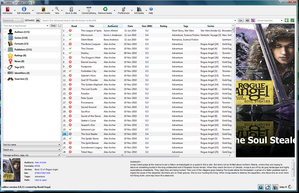

MizSuz described something very similar to what I am seeing. Using the restore column default view does restore the view, but I'd like to keep what I had in the first place.
Hopefully this will show. I have before the hookup of my device after I dragged the column to the left.

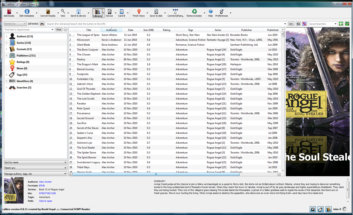

After the device hookup the read column is gone, and so is the on device column.
Attachment 74874
Attachment 74875
Thanks a lot for the help.

The pictures posted by the OP are an exact duplicate of what I am experiencing.
