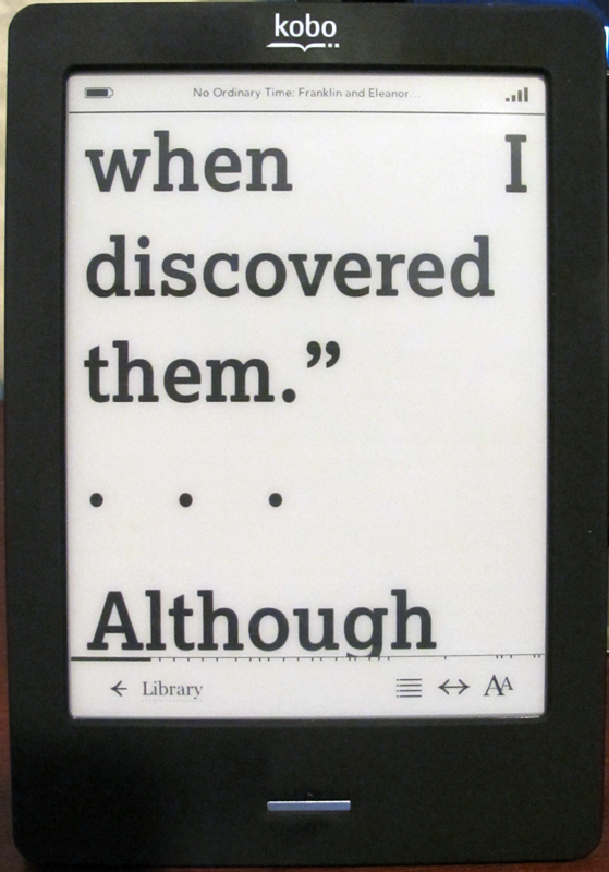

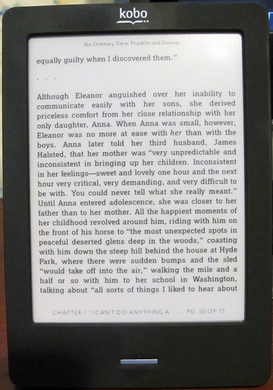

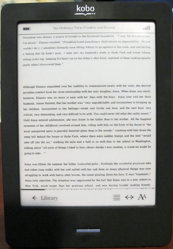

Here are three photos showing Lexia DaMa (a sideloaded) font at the following sizes:
  • Size 1, smallest
  • Size 7, my preference
  • Size 24, largest
As you can probably see the line spacing was set for my preference with size 7 of this font. At size 1, if I could read that small of text, I would most likely use a smaller line spacing to compensate for the tiny font size.
ID:	74180   Click image for larger version
ID:	74181   Click image for larger version
