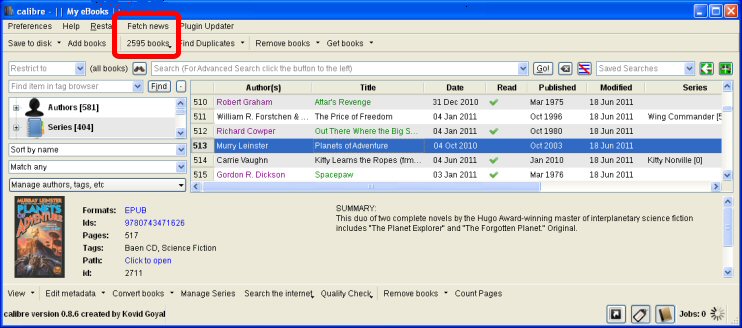

Originally Posted by rogue_librarian View Post
I upgraded to 0.8.6 yesterday. It seems that the number of books in a particular library has disappeared from the menu? I didn't see this mentioned in the changelog. Any chance to get this back? Configurable option, perhaps?
It is there for me.
I use Icons OFF, Show text under if enough room.

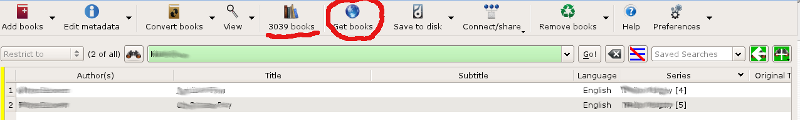

I see now that it only happens when a device (Pocketbook 360, in my case) is attached.
This doesn't only add a "Send to device" button (which would be expected), rather the whole menu becomes wonky, suppressing the "xxx books" line and adding other arbitrary buttons (Get News, e.g., which I've removed from the layout).

Each (7) menu (type and mode) is configurable.
A Device attached switches menus mode.

If you look at preferences -> toolbar, you will see that you can separately configure three toolbars: device-not-connected, device-connected, and the optional second toolbar. These settings interact with the "show text under icons" settings.
My guess is that you have configured only the device-not-connected toolbar.
