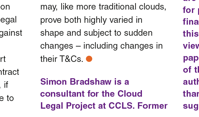

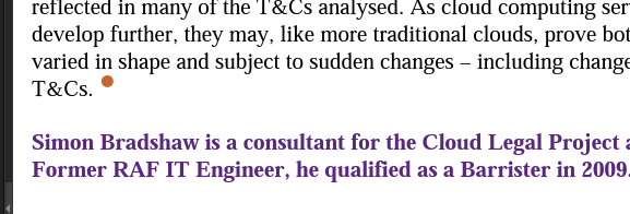

We're attempting to match a print job in ePub. Obviously matching it exactly is not possible but I'm trying to carry as many design features as possible over to the ePub and one of them is at the end of the last paragraph there's a coloured bullet. No matter what I do I can't get the bullet to work in ePub - I can get it to appear, styled with a span, but I can't get it to sit on the line with the 'normal' text and not cause a gap in the paragraph (in ADE). See screenshots attached
The bullet in the attached ADE screenshot is styled as;
span.end-bullet {
color: #C9652F;
position: relative;
bottom: -0.2em;
font-size: 2em;
line-height: 0.9em;
which is a combination of lifting code from here and there. It looks better in Sigil - it's on the line but still causes a gap in the paragraph. There's got to be a better way that works in both...?

Originally Posted by iain robinson View Post
font-size: 2em;
line-height: 0.9em;
Those together mean that the line height for the bullet is 1.8em in the normal text size, and then you get the gaps. Have you tried "line-height: 0"? (I'd also remove position and bottom).

Thanks. Now we're getting somewhere - that change to the CSS means I don't have the paragraph gap any more but the bullet is sitting too high relative to the text (see screenshot attached).
To drop that onto the baseline with the normal text I added
vertical-align:middle;
That makes it look okay in ADE (but maybe a little low). Doesn't look quite right in Sigil (so maybe iBooks too, but can't test it at the moment). is there another/better way to align the bullet?

I don't think there is a bullet-proof (oops, no pun intended) solution, because the size and position of the bullet is font-dependent. But you could include the bullet either as an image (even an SVG image) or as an embedded font, that way you can control the exact position with respect to the baseline...
