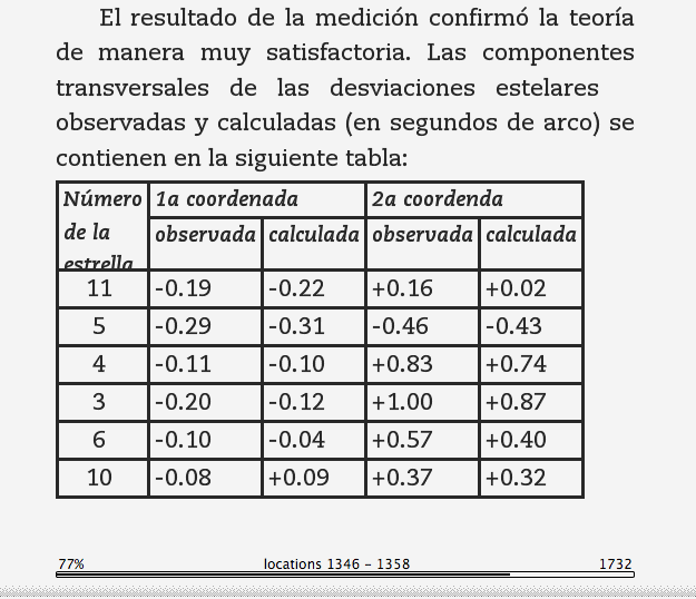

Table using Mobipocket Creator without CSS
Hi
I don't use InDesign, but I have produced a table with borders by hand editing html and using Mobipocket Creator with the following code
<table border="1" align="center">
<tr align="center">
<th rowspan="2">
<small><i>Número<br/>de la<br/>estrella</i></small>
</th>
<th colspan="2">
<small><i>1a coordenada</i></small>
</th>
<th colspan="2">
<small><i>2a coordenda</i></small>
</th>
</tr>
<tr align="center">
<th>
<small><i>observada</i>
The resulting table looks like the attached image.
I have tried using css with Mobipocket Creator, but the support is not very good and the support for tables is even worse. Anyway, I hope you find this helpful.
Name:	Kindle Table.png

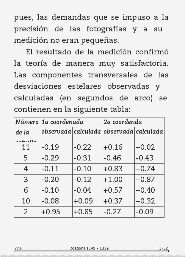

Hi again
I've been doing some testing. The border disappears if I set border="0" or if I remove it, the width does increase with other values; see the image for border="4"
But it is kind of flakey, kindle previewer choked on the chapter with the table once, and I had to restart my kindle too during my tests (probably has to do with rewriting the same file over and over, but I'm not sure).
EDIT: one more note, with border="4" Kindle for Mac displays double thin lines instead of a thick solid one, and at border="5" the table disappears altogether. It shows ok on the Kindle though.
cheers
Name:	Kindle table 4.png
