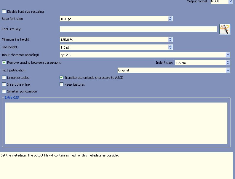

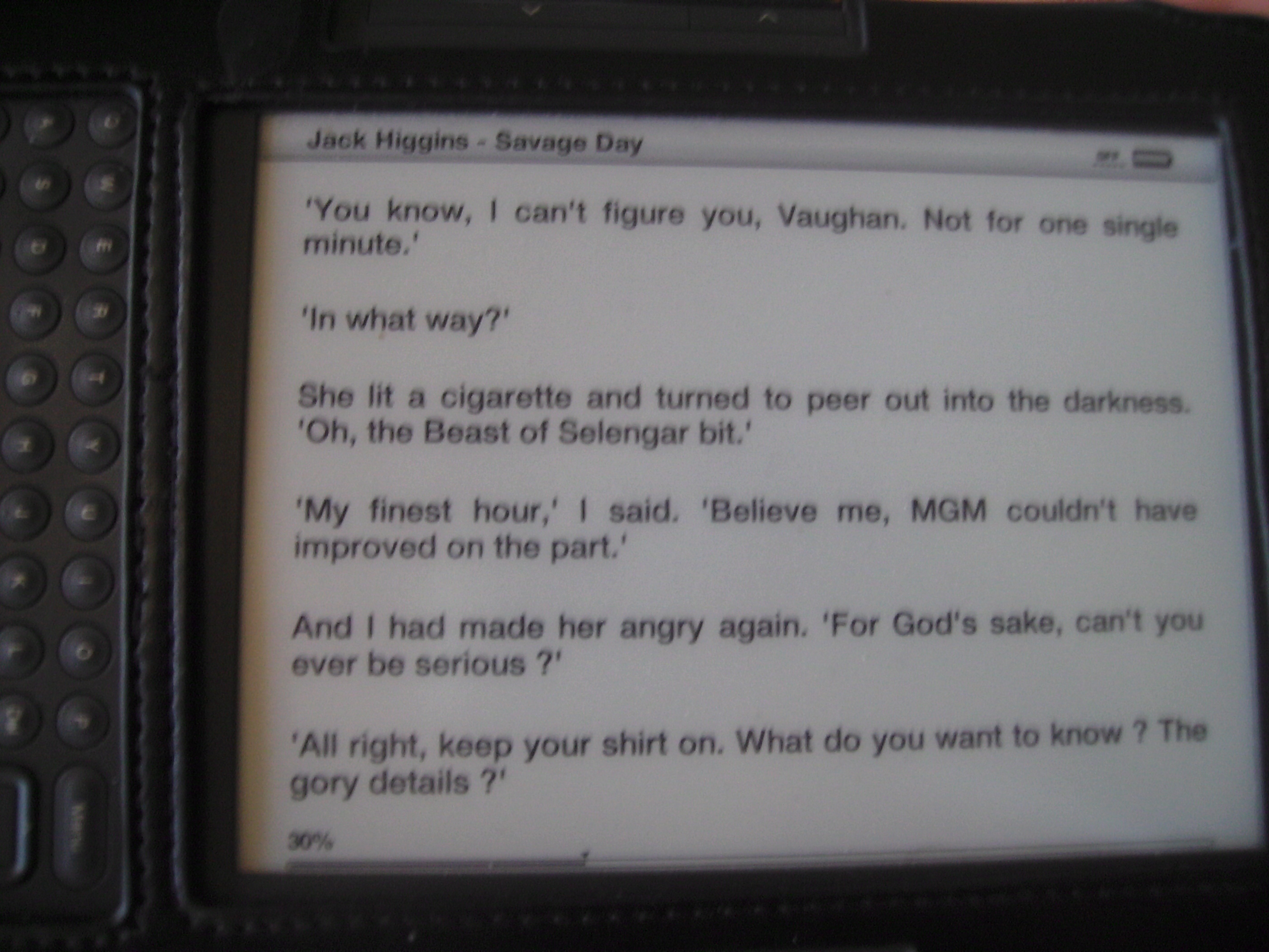

Red face Huge Sentence and Paragraph Spaces EPub to Mobi
I know I have been on and on about this' but I have read and hunted" and I just don't understand the Jargon in these forums about my Problems! The most common is I think answered By a spacing Problem on book the Sentence and Paragraph spacing I have checked "Remove Paragraph spacing" in "Look and Feel" In Callibre (See ScS ) Can someone please tell me in detail how to set this as a Template in Callibre so all the books I convert in future will look the same as Calibri 10 font on a Computer after it's printed on Paper; that's the size I need it to appear in my Kindle?
The closest answer I can find is from [B]theducks in Reply to vanpelten 03-10-11
Can't get rid of paragraph spaces converting to Mobi
theducks suggests the answer of removing the' " class="calibre4" /> " after every Paragraph and that sounds like an answer? But how do I remove it? What do I change it too? Do I Do it in "Sigil "as the EPub format before putting the Book in Callibre and Converting to Mobi? What about the sentences they have huge spaces too?
I have half finished sentences with huge gaps in them also as well as Page and Paragraph Number's halfway down a Page eg Half way down a Page
[ Four ] meaning Paragraph 4 appears and some weird Typos' like this the Name of the Book I am reading is:
The Savage Day and I found this in chapter Four and elsewhere In the Middle of the Page :
jzThe Savage Day
The I have included a Screen shot and a Pic from my Digital Camera (onkindle) hope you can help it's just spoiling the whole Kindle eBook issue for me
Callibre is all in Points How many Points is 10 font anyway is it 10 Point?
Thanks for any help you may give, Dasha

Try Heuristic processing and check Delete blank lines between paragraphs. It might work depending on how the epub is built for the extra spacing between paragraphs.
The problem is usually in the Style sheet of the epub. It can be edited more to your liking just explode the epub using Calibre then edit style sheet then click rebuild epub. If the problem is then fixed then convert to mobi.

To Explode a epub in Calibre just right click on the book in the file list of Calibre and choose "tweak epub" then click explode epub. You will see a folder with a bunch of html files but what what you looking for is a file with the extension *.css like Stylesheet.css You can edit this file in notepad or anything line editor like PSPad, Notepad++, Notepad2...etc then click rebuild the epub when done.
All ebooks are coded in html like an old webpage. You have the ebook you actually see and source code which tells the ebook how to look. Tags are in the source code and between <> symbols. A Style sheet is an external file linked to the actually html. It tells the html file how to display formatting like margins, line spacing, headers, bold, italics and alot more. You can google Style sheets basics to get more of understanding of how to write one.

I had such issues with a genuine e-book from amazon and these are pretty easy to fix. I converted to epub then here is the result (with an excerpt from the book, small enough to be legal):
<p class="calibre4">LIVING IN TRENTON in July is like living inside a big pizza oven. Hot, airless, aromatic.</p>
<p class="calibre4">Because I didn’t want to miss any of the summer experience I had the sunroof open on my Honda CRX. My brown hair was pulled up into a windsnarled, curls-gone-to-frizz ponytail. The sun baked the top of my head, and sweat trickled under my black spandex sports bra. I was wearing matching spandex shorts and a sleeveless oversized Trenton Thunders baseball jersey. It was an excellent outfit except it gave me no place to stick my .38. Which meant I was going to have to borrow a gun to shoot my cousin Vinnie.</p>
You notice the <p class="calibre4"> thing? That mean we need to fix the "calibre4" style in the css.
Here is the css part:
.calibre4 {
    display: block;
    margin-bottom: 0;
    margin-left: 0;
    margin-right: 0;
    margin-top: 1em;
    text-indent: 2em;
    word-wrap: break-word
You see that "margin-top"? It should have a 0 value. Please notice that the culprit could also have been margin-bottom.
Here you are \o/
I converted back my book to mobi and enjoyed it
