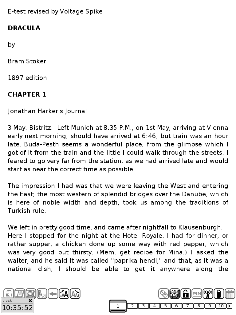

In ipdf the clock disappears when you switch page, but comes back when a new minute starts. ipdf is the only app which behaves like this.

The main crux I have noticed iLiad's pdf viewer ipdf lays above all windowed apps therefore they get "invisible". I have to click on the last known position of gtkclock then it get's "visible" again. Interesting the "dialog-hint bar" with x-button is gone.

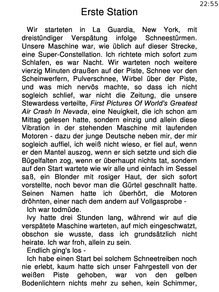

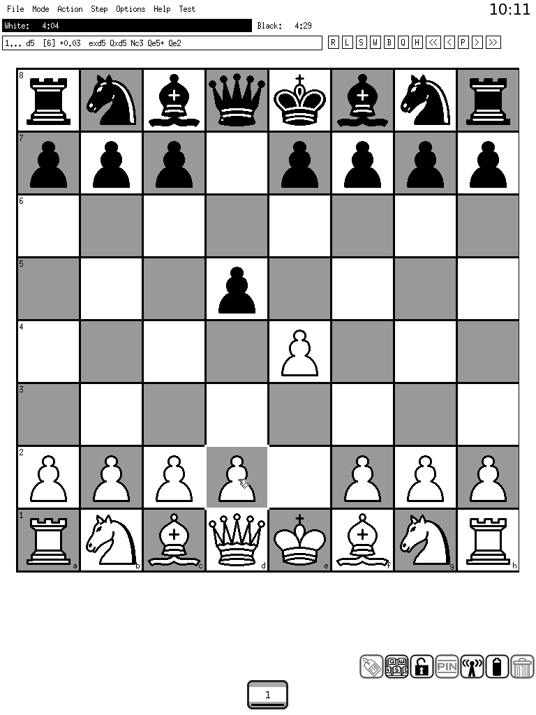

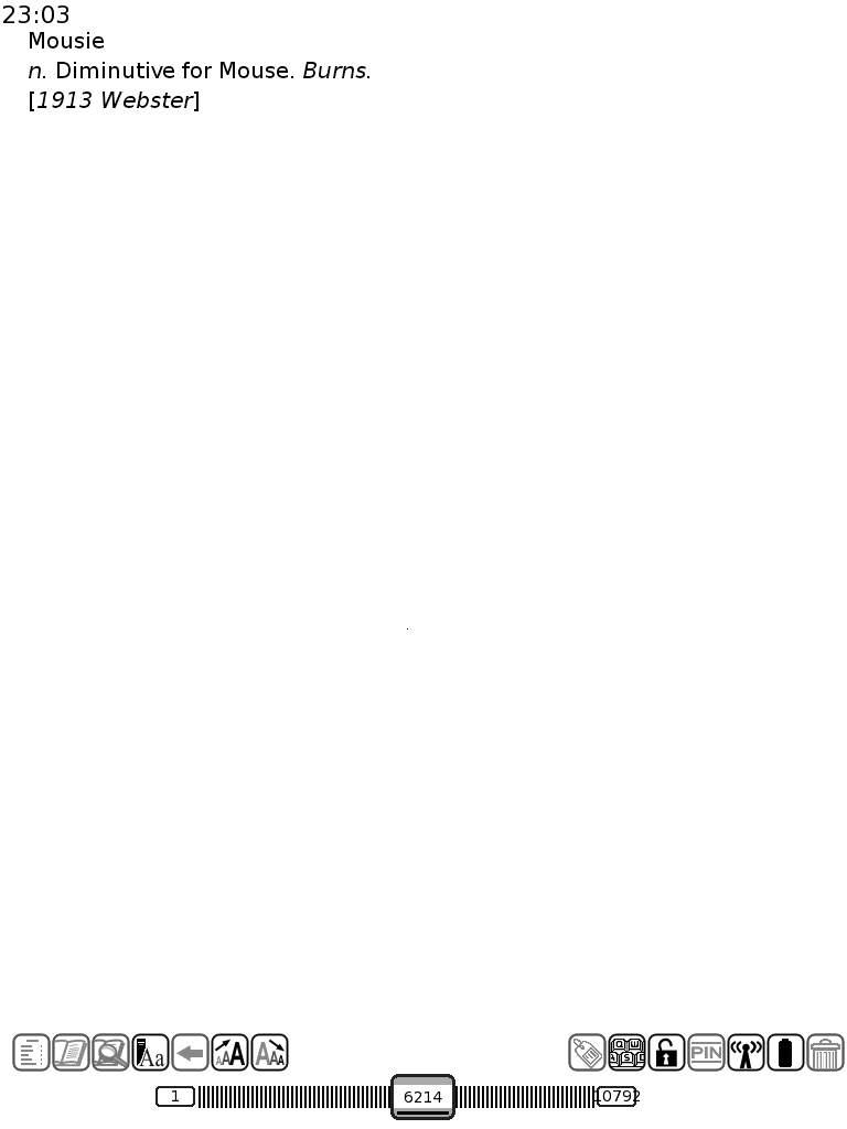

explanation of screenshots:
#1: gtkclock/mobipocket viewer
#2: gtkclock/ipdf
#3: gtkclock/GNU Chess
#4: gtkclock [first version, never published here, moved with stylus to bottom left]/mobipocket viewer
