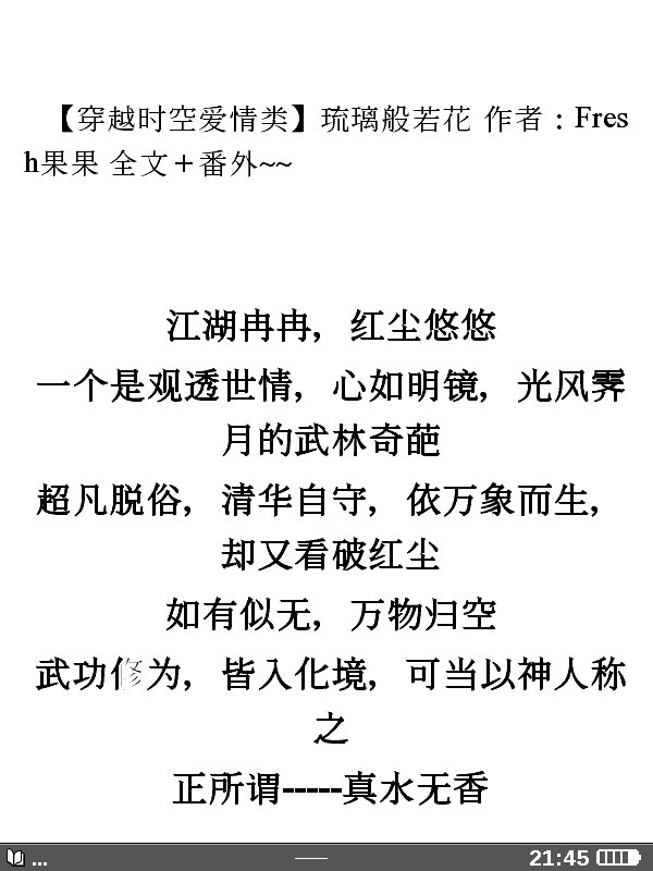

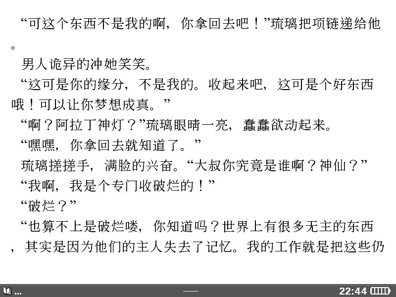

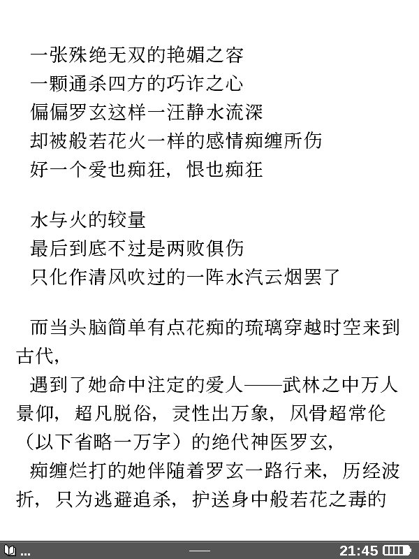

TXT file with standard Fbreader
font used: cyberbit.ttf
coding: automatic (GBK?)
cyberbit.ttf is not provided with the pocketbook but it can be easily found.
even Big5 coding is supported, provided the right font. I hope this helps.

first two screens are in sequence, the third actually is a random page.
Pocketbook comes with different programs for different file types, Fbreader it's the default one for text files, among others.

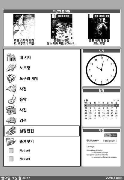

I am not 100% sure whether this will work for Chinese font, but I did some trick on my Korean fonts and force PB902 to recognize Korean file names. Here is how I did it.
1. Select three Chinese(Korean for my case) TTF fonts which is normal, bold, and extra bold(you can still use bold) fonts and copy it to some directory.
2. Google and Download "fontforge" from web (it is open source font editor), I used it in Linux, which is fairly easy. There are versions for both mac and ms-windows, too.
3. In linux, open file with fontforge and select 'Element' in the menu, open 'Font info', then select "TTF names". You can see lists of family and ID names.
4. For normal and bold fonts, replace two of the lists of "English(US)", Family' and 'Preferred Family', from original font name to "Liberation Sans".
For extra-bold font change them to "Myriad Pro".
5. In the top menu, select 'File' then 'Generate Fonts' then save each file with name;
LiberationSans.ttf (normal), LiberationSans-Bold.ttf (Bold), MyriadPro-BlackCond.ttf (Extra-Bold).
6. Copy them into /system/fonts in your PB pro. Now PB will use these fonts instead of the system font.
I can use Korean menu, file name and even Eng-Korean dictionary. Only thing I miss is Korean Keyboard.

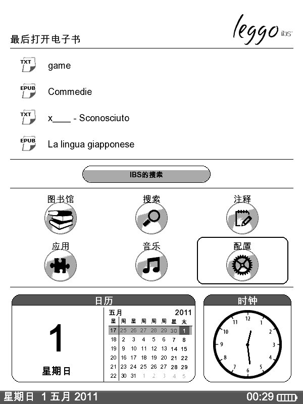

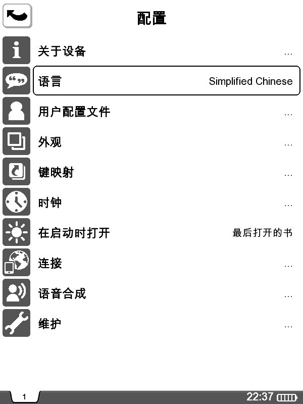

Don't laugh at me I did a "proof of concept" using google translator from English to Chinese...
These are the results.

Ok it works
Thanks to preempalver, I changed a few lines in en.txt in Korean and put it in the /system/language as new name kr.txt.
It works fine with my Korean (fake) system fonts.
