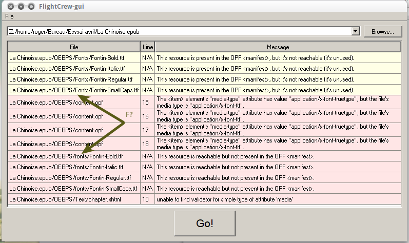

Hi,
I just tried to embed Fontin font in a EPUB (joint file).
The file has been produced by Writer2xhtml, the embedding (using @Font-face) and drop-cap has been done using Sigil.
I checked the result with FlightCrew (see photo).
I know the middle remarks (about true-type) are not important.
I am puzzled by the fonts/Fonts remarks (see arrows). I feel a little like the small dog running after its tail. I'm sure the solution is round the corner. It's about f and F but which file am I supposed to modify and how?
I also do not understand the last remark about validator.
Any tip welcome.

The font path is case sensitive. What version of Sigil are you using? If you used Sigil, and only that, to embed the fonts, it sounds like a bug ...
I used Sigil to import the fonts, to complete the style-sheet with font-face and drop-cap texts, and to insert the drop-cap and that's all.
I still stick to the 0.24 version (Linux) which had been up to the task.
Writer2xhtml creates a Fonts folder. Sigil seems to expect a fonts folder? I will try with a Fonts folder...
I resumed all the process. I probably did a mistake in between because now it seems OK even if the end result is not specially nice, but this is another matter).Now, no more FlighCrew protest but slightly different displays with Sony, Firefox, Lucidor, calibre and Sigil even if "globally" Fontin is used.
Still something to learn...
Thanks for your help.

Sigil's (normal) folder would be Fonts.
the path has a lowercase fonts in it.
Just edit the Paths shown that are pointed at in the Red section to use a capital F
Thanks theducks, I did just that with V2. Now, I have no more errors reported with FlightCrew.
