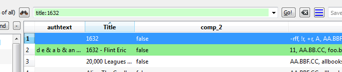

Highlighting works fine for me with any search. I need more info about what you are doing/seeing.
Is the search returning one book? In that case, the book is highlighted, but the highlight is hidden by the selection.
Are you looking at the device view? Highlighting isn't supported there. I will change the code to hide the button.
Something else?

The 'one result selected' confusion got me thinking. As it is, when marking is on, there is no visual way to distinguish between no results and 1 result because the selection overrides the coloring. I propose changing things so that if marking is enabled and the search returns nothing, the library view will be positioned at line 1 but nothing will be selected. If a result is returned, the library view will be positioned at the first (and perhaps only) result, and that line will be selected.
