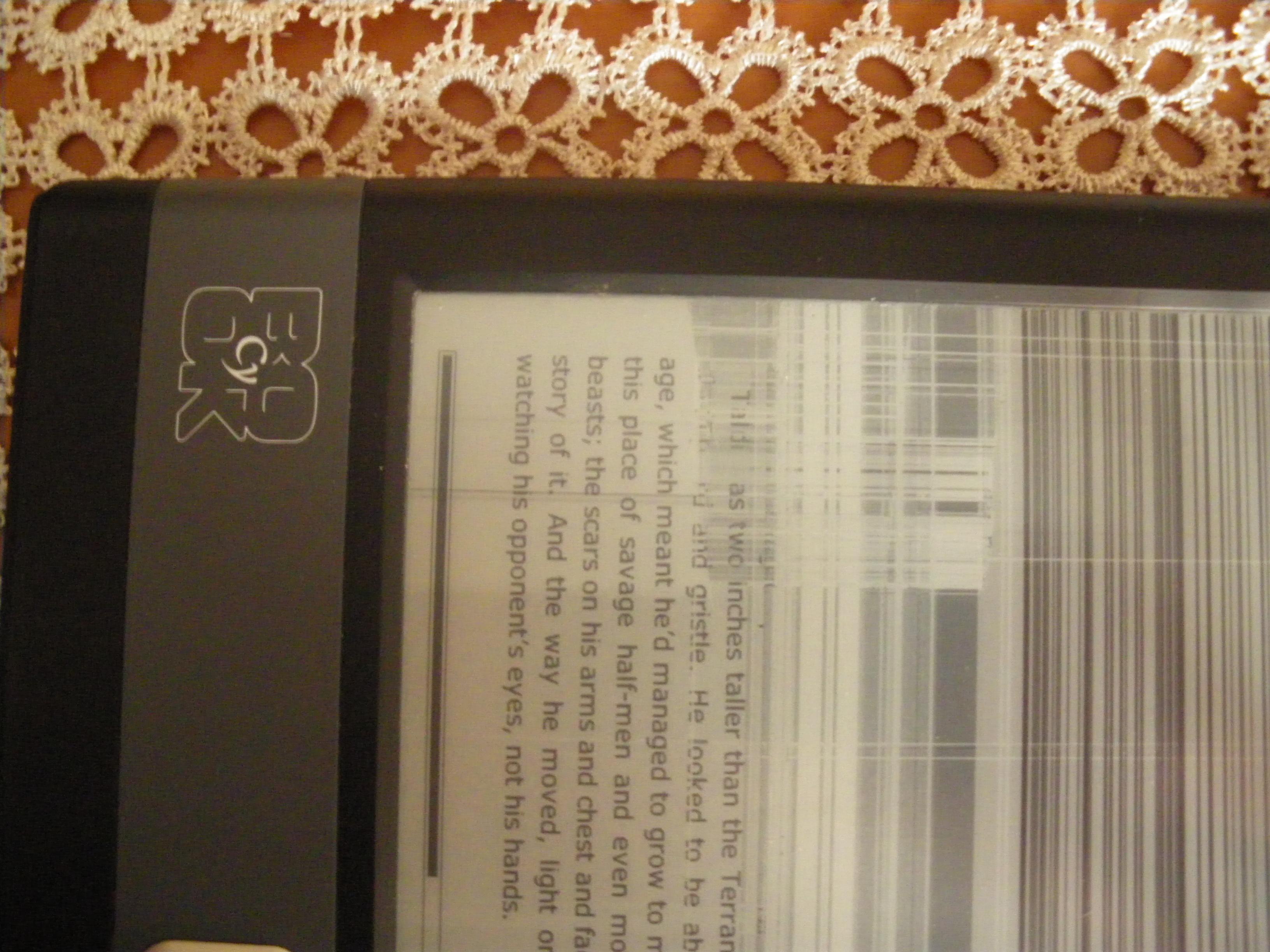

Can somebody tell me if the screen is broken ? The unit can still connect to a PC and I can read & write from the Cybook memory , but the lower half of the screen is locked into some sentences of an ebook I was reading and if I try to reboot the Cybook the upper half either becomes black or white or in stripes.
Is it worth (moneywise) changing the screen, eventually ? Anybody knows how much it costs ? Do you need a specialist ?
Thanks and regards
Bruno

Not sure about the price, I paid mine 130 euros back then, but i think prices went down.
Contact bookeen, they'll tell you how much it actually cost.

That might be a broken screen controller card, not a broken screen. The even parallel lines across the screen look like a controller issue IMHO.

The screen and its controller are a single unit, so yes, this is a broken screen. It looks, though, like a controller fault rather than a broken screen substrate - not that that will affect the price of replacement.

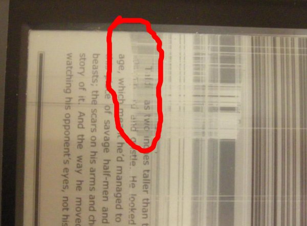

I'm not an expert, but I disagree. This part (see attachment) looks like a broken substrate, note that the "crack" like is not straight and vertical/horizontal.
If it were just a controller fault, it could be covered by warranty, if it's not expired.

You're right - I'd overlooked that, and I agree with you. Broken substrate.

It's not necessarily because of a shock or fall, twisting or bending forces can also break the substrate (wich is a very thin glass layer). Moreover, a crack can appear some time after the cause, remaining "latent" until the stress cannot be contained anymore: temperature changes or vibrations can reveal such latent cracks.
