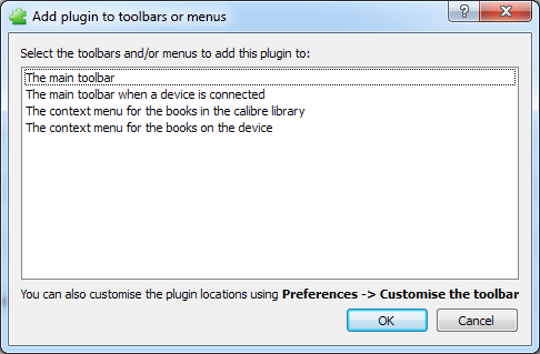

Kovid mentioned on another thread the idea of popping up a list of possible menu/toolbar locations a user could display a GUI plugin in when adding a plugin. This would be great to stop the almost daily posts from users who cannot figure out how to add or only put it on the toolbar.
I said I would have go at adding this, but have hit a snag. The "dont_add_to" set of locations resides on the InterfaceAction class. At the point this code will reside in plugins.py you only have "plugin" which is a subclass of InterfaceActionBase. The gui actions are not instantiated until after a Calibre restart.
So how can I get to the "dont_add_to" set? Is it "safe" to call load_actual_plugin and then query that object? Presumably that means there are two instance instantiated temporarily for when you are upgrading plugins, is that ok?

I went ahead and instantiated the action. I needed to get the name attribute as well add to the menus/toolbar anyway which is the same issue.
I have made the behaviour that the dialog only appears if (a) it is a plugin inheriting from InterfaceActionBase, and (b) you have not previously added the plugin to a menu or toolbar. The latter is because I figure users upgrading will not want to get nagged by the dialog.
Edit - just saw chaley's post. The problem is I don't have a handle to the class without instantiating it since it is "unknown"?

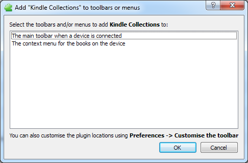

meme, I don't get that behaviour. Are you sure you hadn't added it to the main toolbar in some other way in the past before you did the dont_add_to?
I just now did these steps:
Preferences->Plugins->Uninstall Create Kindle Collections
Without closing dialog, Add new plugin of KindleCollections.
That gave me the dialog in the screenshot attached.
I chose the top option of "The main toolbar when the device is connected".
Clicked OK.
Restarted Calibre.
As you can see from the second screenshot your plugin is not present.

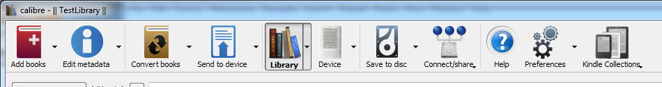

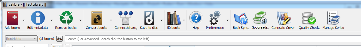

But when I plugin my Kindle, the plugin appears as expected?
