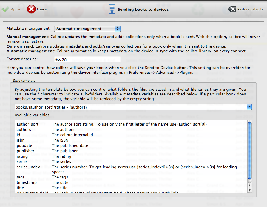

on a side note can anyone point me in the direction of an explanation on how to have calibre send books to sd/myfiles/books as apposed to sd/ I have been looking for a few hours with no luck. Everything I have come across details older versions that have slightly diff. methods then 7.47.

Not exactly sure what your saying here, I select the book/s that I wish to transfer, select storage card a - and the books end up in the main directory of the sd card ex. sd/ and therefore do not show in my library. They should be in the book folder of the sd card something like sd/myfiles/books where they will be seen by the nookcolor and appear in my library. I do not know enough to change the template under preferences/send to device to make this happen.

Well after a few frustrating days...I updated calibre to 7.48 and when I attempted to customize the nook color plugin...ta-da...I was greeted with file and directory options as apposed to "Plugin does not need customization." I simply added My Files/ to the tempate string and now I have full control of my book placement!
You can also achieve the same thing (using any version) by choosing Preferences > Sending Books to Devices (under Import/Export)
i tried and tried different ways my files/ - with space/without
My Files/Books - again with and without spacing
i tried listing the exact address including the drive letter
i just could not figure out what format/string setting/way to type it...so i was stuck
When you're ready to transfer your books...From the menu bar at the top of the screen select Send to Device > Send to Storage Card A
You don't include the drive letter or anything for the storage card location in the Preferences > Sending Books to Devices.
My Files/Books/{author_sort}/{title} - {authors}
If you run the Welcome Wizard and choose NOOKcolor as your device, it will automatically send the books to My Files/Books.
