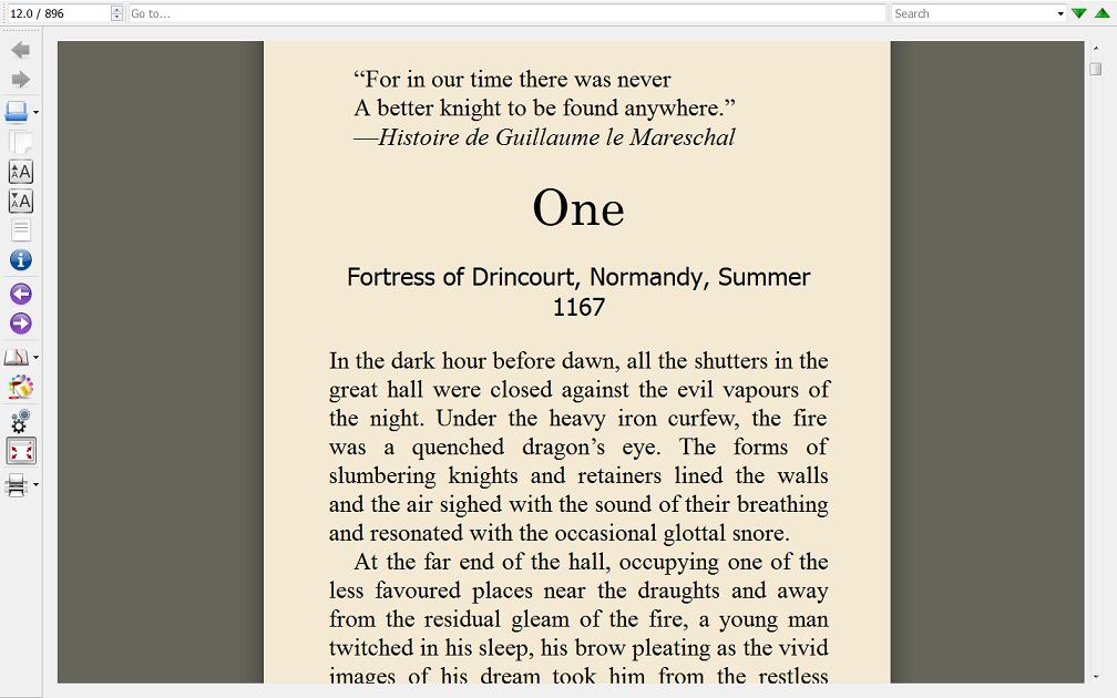

OK, at a maximum view width of 1440 px (select that under the 1st tab of viewer options) this css works with the attached image to give a K4PC Sepia look:
body {
color:#000000;
background-color: #f1e7d0;
background-image:url("file:///C:/Program Files (x86)/Calibre2/resources/images/k4pc_bgd2.jpg");
margin-right:250px;
margin-left:275px;
The directory you choose is up to you...
And you can play with the margins to get them however you want...
...argh... only on .mobi files. epub ignores the margins. I know I've read about this, but I'm too brain-dead to remember why. Maybe tomorrow.
ETA: checked a few more books - these all work fine in epubs that don't have margins set in the book's source.
edit - changed css margins and attaching a better background image to use. First one didn't account for left toolbar, so it doesn't center... this is at least close... still off, seeing screenshot - doesn't seem so off when in the ap...

Here's the background image and css for a narrower center column, ad screenshot of how it appears at 1440 res full screen:
body {
color:#000000;
background-image:url("file:///C:/Program Files (x86)/Calibre2/resources/images/k4pc_bgd4.png");
margin-right:330px;
margin-left:350px;
ID:	67449   Click image for larger version

I just added what he said to user styles - looks good to me with both epub & mobi.
side by side - calibre viewer & K 4 PC, the latter is a tad darker / more brown, but I am not fussed. cailibre viewer is much better than the default white. Shame the TOC panel stays white though
