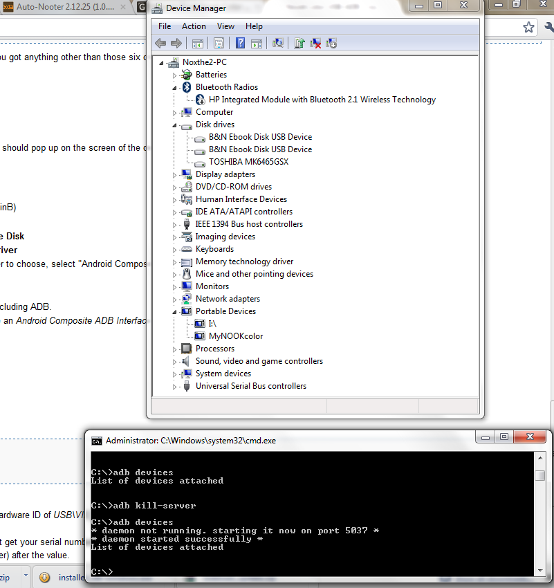

Hi again! I'm sure people are getting sick of me, but trust me! Once I get this all sorted out, I'll be more than happy to help others.
So this is where I'm at:
http://nookdevs.com/NookColor_USB_AD...2C_Vista_and_7
I'm getting stuck at Part III. The attached image shows the categories where I see my NookColor show up. When I try to update the drivers for this device though, the inf that I unzipped per the instructions in part 2 isn't a valid driver.
The guide says that my Nook should be under "Other Hardware," but it's not. See the image below.
Thanks for any help.

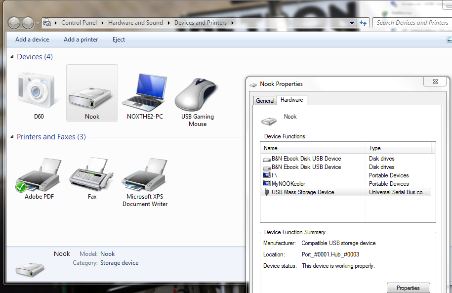

WOOHOO!
I figured it out!!!
Because I'm brilliant, I went into DEVICES AND PRINTERS, hit properties on my NC, and then in the hardware list, I picked the USB hardware entry because it just seemed to make sense.
However, that hadn't occurred to me until I made this post, so I'm glad I've got this forum, even if it's just to bounce ideas off of.

Ok, once this was done I had to go back into that screen and uninstall the USB driver, unplugged, plugged back in, and it installed properly. Tested successfully.
t3l01v is offline   Reply With Quote

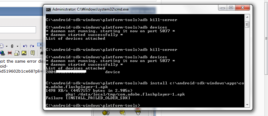

So I tried to install Flash Player and got the same error discussed here:
http://groups.google.com/group/andro...02b1ce68?pli=1
That said, how do I figure out which version of Android I'm running, and how do I find APKs for that version?
Sorry all, new to the Android community with my NC. My brother swears by Android OS, but I've been a hardcore iUser (iPhone, iPad, etc.)

The NookColor currently runs Android 2.1. Some hackers have a partially working 2.2 android Rom, Nookie Froyo, available for use on the Nook.
I don't believe there is a fully working flash player for 2.1 (there may be limited, partially working ones). You could try Nookie Froyo.
