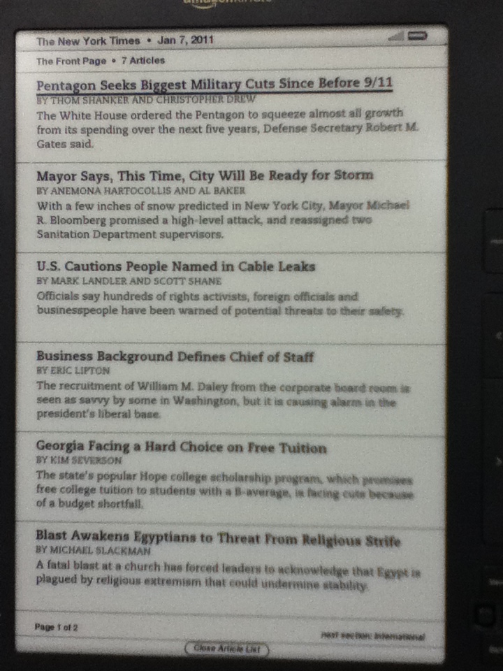

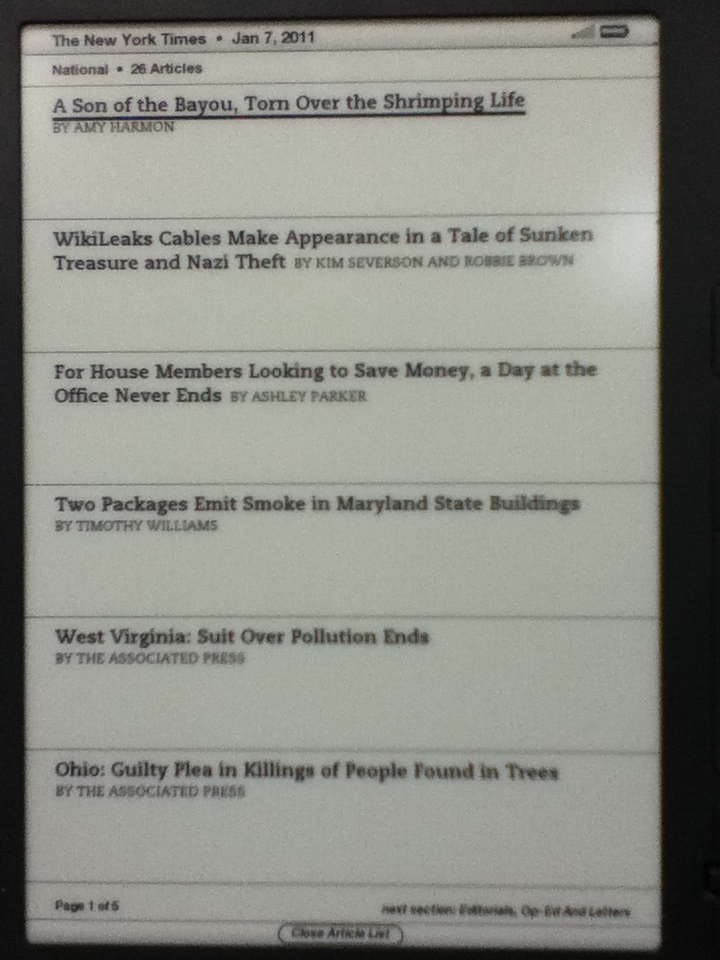

Hello,
This is my first time posting, but I hope to get more involved, love Calibre and hopefully I can contribute back somehow. A few things, but #1 is the most important.
1) One thing that could substantially improve the Calibre New York Times news subscription is having the article descriptions in the menu. The descriptions are in the menu for the Front Page articles, but not for any other articles (see what I'm talking about in the two pictures of my Kindle). It would be very easy to fill in the description with the first two sentences from the article in the case where the description is blank rather than leave it blank.
I spent several hours trying to customize the recipe to use the first two sentences but couldn't figure out how to get a hold of the text body.
in the handle_article function these two lines set the description from what I can tell:
description = ''
pubdate = strftime('%a, %d %b')
summary = div.find(True, attrs={'class':'summary'})
if summary:
description = self.tag_to_string(summary, use_alt=False)
How would we update these lines to parse out the first two lines from the article rather than the blank string?

1) Use the populate_article_metadata method.
3) It wont make any difference, calibre supports paywalled sites just fine, see WSJ for an example.
