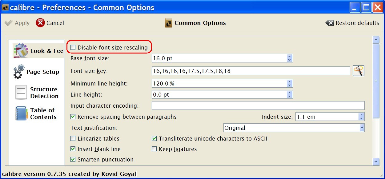

Since a few weeks ago the news items I download and email to my K3 display with a really big font. It used to be OK.
Does anyone know what to do about this? Is there a setup somewhere or a CSS?

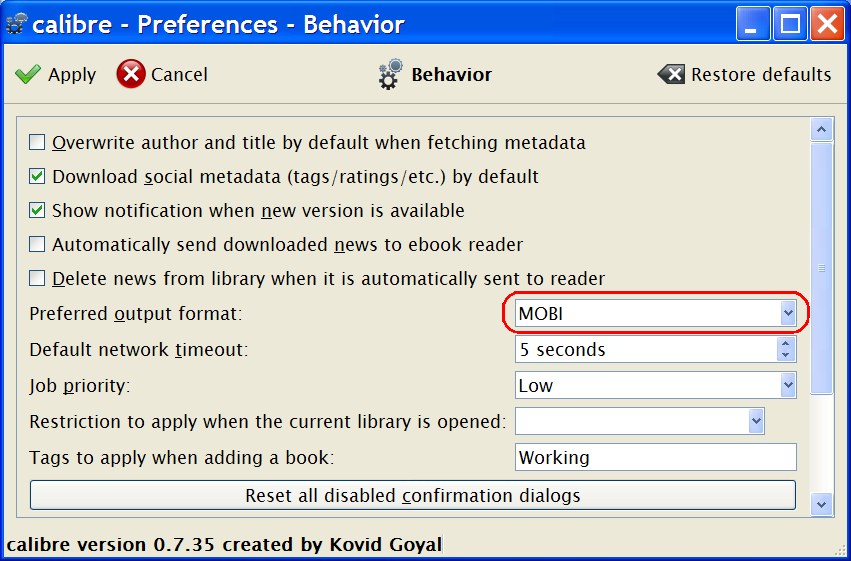

  3. Go to Preferences - Behavior, what format are you saving the recipe as (see attached)?
  4. Is it Mobi? If not change this to Mobi for your Kindle.

  7. Go to Preferences - Common options, do you have Disable Font size rescaling checked (see attached)?
  8. If no to the previous question, what settings do you have showing.
After you provide the info someone may have an idea where your problem lies or ask you more questions. The settings I have in the attached images are what I use and are not being suggested for common use. I purposely increase the font size to 16pt as a way to avoid reading glasses.

Originally Posted by dwanthny View Post
[*]Go to Preferences - Common options, do you have Disable Font size rescaling checked (see attached)?
Thanks dwanthny. That solved it. Much appreciated.
