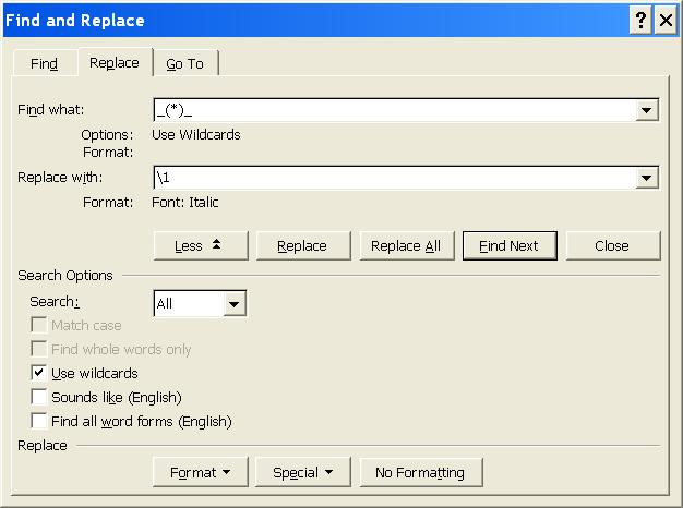

I have an epub of a book that instead of words being italicized has words in between underscores. As it is a very basic book, I converted to RTF and opened it up in Word (can't install SIGIL on any of the computers I use at school) to use the almighty Find and Replace tool. However, I'm now at a loss as to how to change the words between the underscores to italics AND remove those underscores.

Try this:
Using Word Find & Replace:
Check the 'Use Wildcards' box
In the Find box, type
_(*)_
In the Replace box, type
\1
then [Ctrl]-I or Format - Font - Italic to specify Italics
Then press the 'Replace All' button
Attached is a screencap of the Find/Replace box in Word so you can see what it should look like.
Caveat: My version of Word is pretty old. The box may have changed.

Excellent. That worked perfectly. Thank you!
