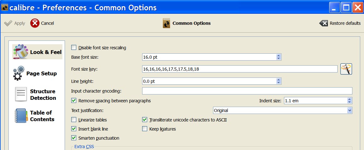

I use a constant setup with the base font and font size key setup as in the attached image. Occasionally some of the lines of a given html might overlap. When I run into that I just set line height to 1.5pts higher than the base font size. For my setup this ends up being 17.5pts for line height.
You can read more about font scaling here in the manual.

Thanks for the reply. I have read the manual several times.
I have tried something along the lines you suggested (limited key) before but I will try your suggestion as well.
I selected three books that have different font sizes on the Sony and opened them in Firefox (EPUB reader) as well as Adobe Digital Editions. The fonts all look the same. I also increased and decreased the font sizes in these books and retried them in Firefox and Adobe and I can see the changes. So the problem seems to be related to my Sony.
Which device should I select for output to the PRS 650 (I now use plain Sony Reader)?
