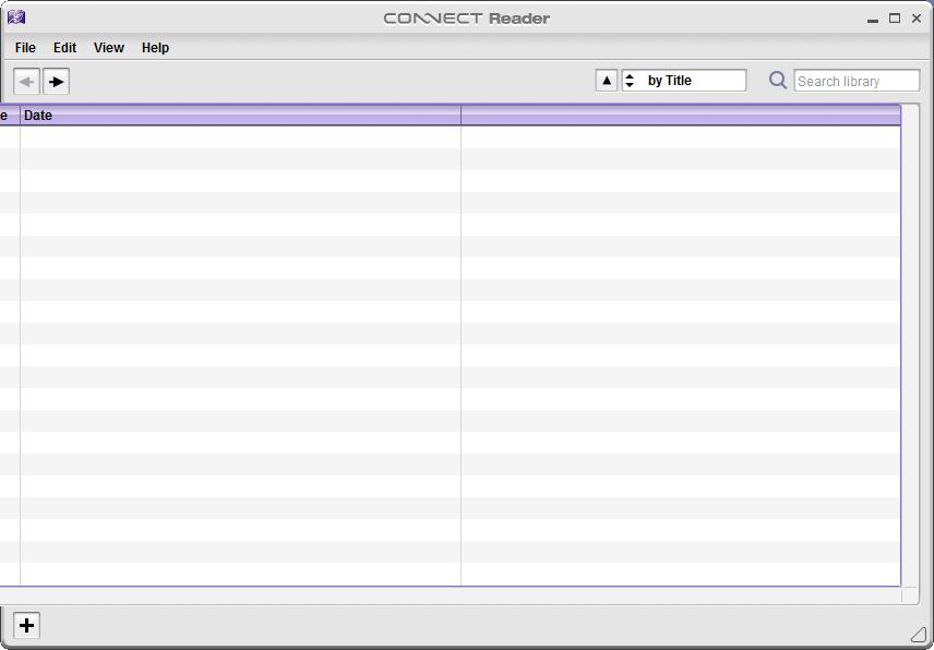

Is anyone out there using the connect software successfully with Vista? I find it is totally unusable; the entire left hand panel is missing (see attached screenshot).

Are you using Connect 1.1? That should work fine with Vista.

I confirm that Connect 1.1 works fine for me here (Vista Business).
Link to Connect 1.1 upgrade: http://esupport.sony.com/US/perl/swu...d=2475&SMB=YES

Yes, I am using the latest version off the Sony site (the one that is supposedly Vista compatible). I even finally went and did the firmware upgrade on my reader, which I had been reluctant to do. And I uninstalled and reinstalled the Connect software several times.
Of course Sony have no e-mail support, and I know from past experience trying telephonic support would just be an exercise in frustration. I guess that is the end of me and Sony Connect then. :-(

Let me guess, all those that have succeeded in getting the Connect soft to work under Vista are using the x86 (32bit) version?
I've tried everything that's been mentioned in this forum to get this working under my Vista x64 Ultimate. I've tried the admin install, I've tried the new (and old) version, but so far no go
If anyone has any solution, please share it with us

Unfortunately, it looks like the Connect software only includes a 32-bit version of the driver it uses to talk to the reader. (At least, I only see a 32-bit driver when I do an admin install and look through the files.) So, it looks like the current package just won't work on x64 (actually, I think the Connect program will run, but it can't talk to the reader).
Does anyone know who we could contact at Sony to put in our vote for supporting x64? I imagine all they'd need to port is the driver; the rest can stay 32-bit. The driver is only 19K.

This isn't an example of x64 Windows not being "ready." It's because Sony hasn't supplied a 64-bit driver. There's nothing to fix in Windows to make this work; the only solution is for Sony to write a 64-bit driver.
And yes the x64 version is a downgrade.
I wouldn't put it quite that way. It's not that there's something wrong with the OS, it's just that software and hardware vendors, for whatever reason, are not supporting it much.
That's right, the software runs, but doesn't talk to the reader.
Of all the software I use regularly, this is the second along with Cisco VPN client that doesn't "talk" 64bit
