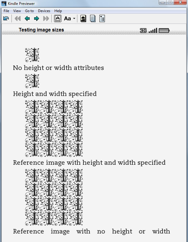

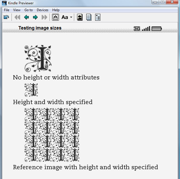

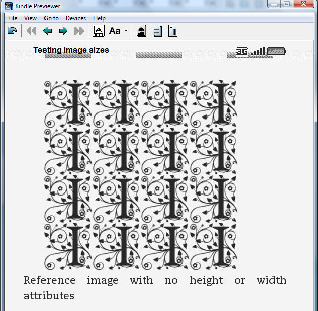

That's not entirely true. However your reply made me do some more testing, particularly in relation to the use of the "hisrc" attribute, and in Calibre's conversion to MOBI format.
What I've found:
1. If you don't use the "hisrc" attribute as well as the "src" attribute, you do need to have the image height and width attributes specified, for the Kindle. If you don't, and the image fills less than 25% of the screen, it will be expanded to twice the height and width of the original. If you do specify the image height and width, it will be displayed correctly. See attached "testimagesizesnohisrc1.jpg" and "testimagesizesnohisrc2.jpg".
2. If you do use the "hisrc" attribute, the Kindle will use that rather than the "src" attribute, and will display that image without expanding it. See attached "testimagesizeswithhisrc.jpg".
(The MOBI files for these screen shots were created by running two almost identical HTML files through Kindlegen - the only difference between the two HTML files was that one included the "hisrc" attribute in each IMG tag, whereas the other didn't.)
3. Calibre, when converting to MOBI format, appears to be discarding the "hisrc" attribute, and also discarding the image height and width attributes. I used Calibre to create a MOBI file from an EPUB in which the HTML included "hisrc", "height" and "width" attributes, and then to convert the MOBI to OEB. When I examined the resulting HTML, all three attributes had gone.
