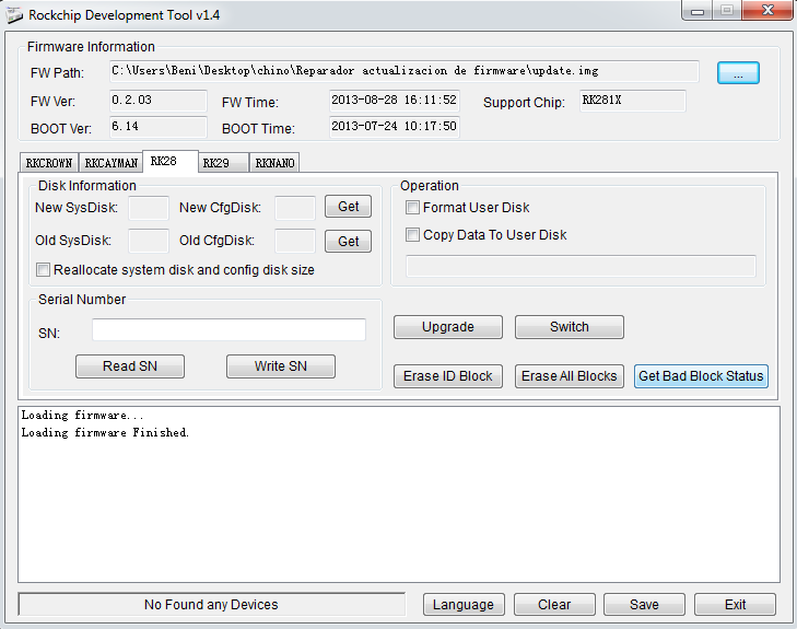

i bought a boyue g10 (the second version of this one) and i have the same problem.
when i was desesperate two weeks later, i found a tool in a chine page called RKDevelopTool. I connect the ebook via usb, load a img firmware update, and i push the "Get Bad block status" buton. Suddenly, the frozen display wake up.
It's a long time ago from the original post, but its important that someone that looks for a g10 frozen eink display knows how to proceed.
Sorry for my english.
Hi!
Can you please provide a link to RKDevelopTool program and link to firmware?
Please please, my G10 cannot boot anymore, i have no idea why
dcrystalj is offline   Reply With Quote

The tools:
https://github.com/onyx-intl/rk_tool/archive/master.zip
There are several folders, one of then is named 开发工具, and inside there is a program called RKDevelopTool.exe. Change the name of the folder to ascii characters, and after it to put the program in english, you must push the button language (see the image in the other post). My solution was push the Get Bad block status.
i found two types of firmware. One of then, must be colocated in a formated with FAT (not FAT32) sd card of 2G. After formatting, copy the file update-sd.img into the sd, and start the ebook pushing at same time the power and ok button for at least five seconds.
This is the official last firmware
http://download.boyue.com/downloads/G10-0723.rar
The other firmware, necesary to use the tool, in a chinese page http://pan.baidu.com/s/1kTmHYcB.
Direct link: http://117.27.243.40/cdn.baidupcs.co...wsiphost=ipdbm
with this firmware, you can use other tool included called RKDeviceManage, which can update the firmware without a SD card.
To use this programs, you must connect the g10 to the pc via usb, and push the buttons ok and power for five seconds or so.
kreti is offline   Reply With Quote

Thanks man! I found best solution was to download original firmware and put it on FAT SD card. And run it just as you said.
Is there any ql difference on second firmware ?
I really miss some features on my G10. Do you know if there is a way to put amazons firmware on it? The most missing feature for me is not being able to put content on it via email. Every time I have to connect cable, send, restart it and then open the file. It is far to long process for me.
