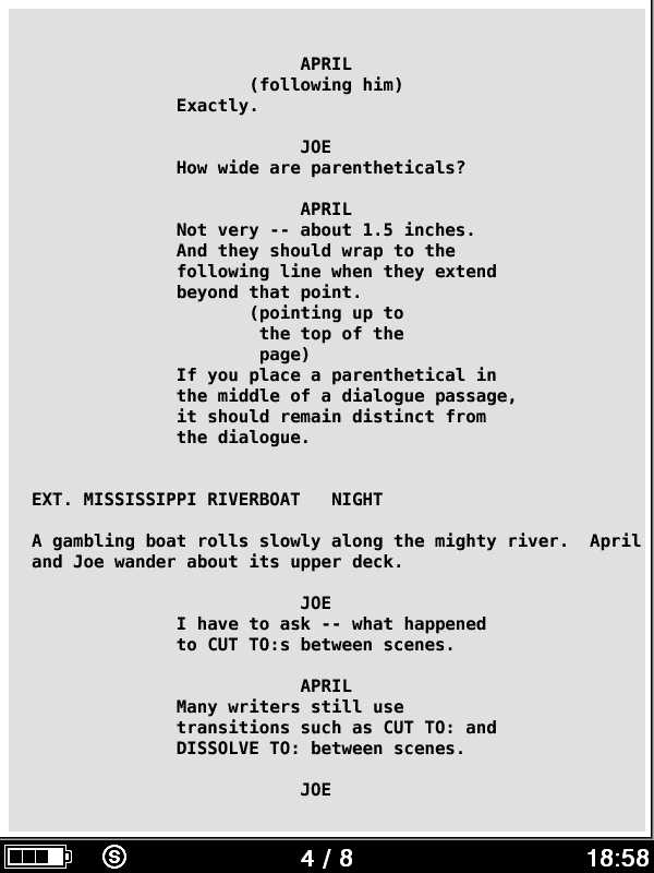

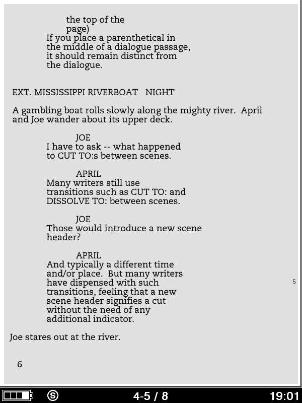

In an EPUB on a Sony reader, by default, the <pre> tags will cause the text to display in the reader's EPUB default monospace font. I'm not sure whether the Kindle has a monospace font, but if not, I'm hoping that it's default serif font will still display the screenplay MOBI OK.
The first attached screenshot shows a page of the EPUB in my Sony monospace font.
The second shows an EPUB page in the Caecilia serif font which I believe is similar to (the same as?) the Kindle.

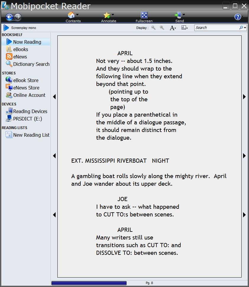

I'm attaching the exact .html file I dragged into Calibre. I'm also attaching the MOBI conversion and a screenshot of how this MOBI looks in MobiPocket Reader on my PC.
1. Send the MOBI to your Kindle without any conversion.
2. If this looks OK, rename KB_screenplay.html.txt to KB_screenplay.html and import the HTML into calibre which will zip it up. Then convert ZIP to MOBI. Send this MOBI to your Kindle.
If MOBI 1 looks OK and MOBI 2 doesn't then we need to look at the Convert settings more closely. If MOBI 1 doesn't look something like the Mobipocket screenshot then I'm stumped!
