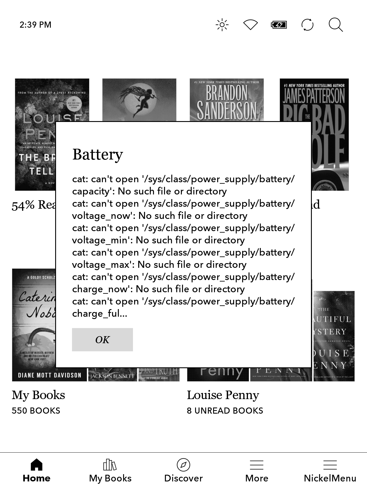

I decided to install the battery script on my Libra 2. I'm running 4.38.23171 and it's not working. Here's what I get.
Attachment 212485

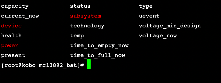

When you telnet/ssh to your Libra 2, what directories do you see in /sys/class/power_supply/? Are you modifying the script to match what is displayed there? See message #1418 in this thread for @Dirk-71's comments.

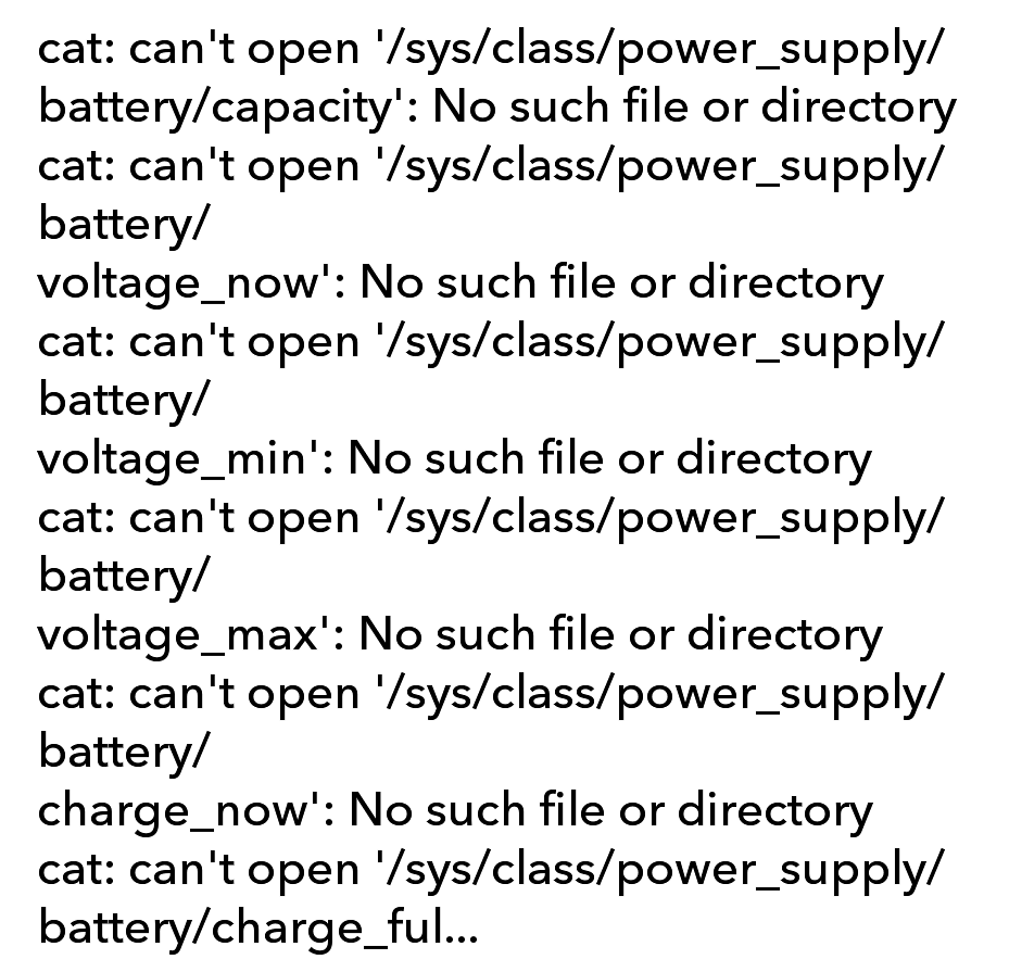

I have the Kobo Libra 2 with latest firmware 4.38.23038. I get the following error messages. Maybe the path has changed with the latest firmware?
Attachment 211406
SOLUTION:
The path and the commands have been changed in the latest firmware. So, the script has to be adapted accordingly. The path is mc13892_bat instead of battery:
Attachment 211407

Without knowing more, it could be just a matter of changing all instances of /sys/class/power_supply/battery/ to /sys/class/power_supply/mc13892_bat/ in the script.
Which commands replace which commands?
As a start, try following the instructions posted by that fine fellow, JSWolf in the message quoted above.
