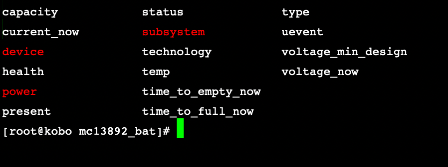

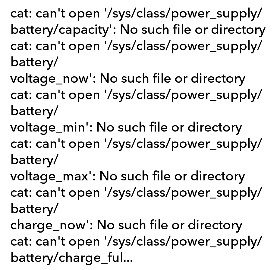

Originally Posted by Aleron Ives View Post
I've made another update to my battery statistics calculation script. Version 1.2 brings a few improvement.
I have the Kobo Libra 2 with latest firmware 4.38.23038. I get the following error messages. Maybe the path has changed with the latest firmware?
SOLUTION:
The path and the commands have been changed in the latest firmware. So, the script has to be adapted accordingly. The path is mc13892_bat instead of battery:
