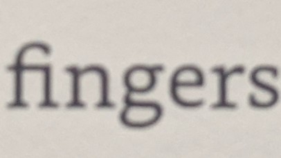

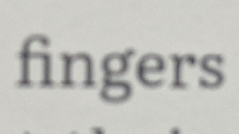

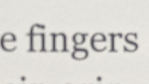

Here's the same word from the same kepub on my Kobo, rendered with Bookerly, Georgia and Literata Book. Please explain why only Georgia doesn't correctly display the 'fi' ligature.
You read in ePub on a nook, so do the same on a Kobo.
