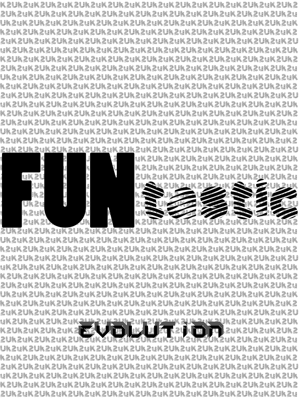

Yet another...
#!/bin/sh
#FUNtastic.sh:
# Play with OpenType fonts and transparencies to write an appreciation message
cd /mnt/us
#expects PATH=$PATH:.:..
#Fill a background of karma
fbink -c  -C gray8 -t regular=/mnt/us/pantspatrol.ttf,size=8 "K2Uk2uK2Uk2uK2Uk2uK2Uk2uK2Uk2uK2Uk2uK2Uk2uK2Uk2uK2Uk2uK2Uk2uK2Uk2uK2Uk2uK2Uk2uK2Uk2uK2Uk2uK2Uk2uK2Uk2uK2Uk2uK2Uk2uK2Uk2uK2Uk2uK2Uk2uK2Uk2uK2Uk2uK2Uk2uK2Uk2uK2Uk2uK2Uk2u"
#Write over "FUNtastic"
fbink -t regular=/mnt/us/poplarstd.otf,size=86 "FUN" -M --bgless
fbink -t regular=/mnt/us/pantspatrol.ttf,size=48,left=280 "tastic"  -M --bgless
#Add text 3D Shadow effect showing « yet another fbink evolution »
fbink -O -y 20 -S 1 -m -C gray5 -F block EVOLUTION
fbink -O -y 20 -S 1 -m          -F block evolution
#save for posting
screenshot

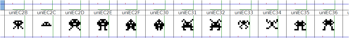

What am I missing?
I am trying
fd=/mnt/us/fonts/
fbink -c -t regular="$fd"unscii-8.otf,size=60 -m -M "        "
#\uEC2B \uEC2D \uEC2E \uEC2F \uEC30 \uEC31 \uEC32 \uEC35 \uEC36
accessing the unscii-8.otf Private Area Click image for larger version

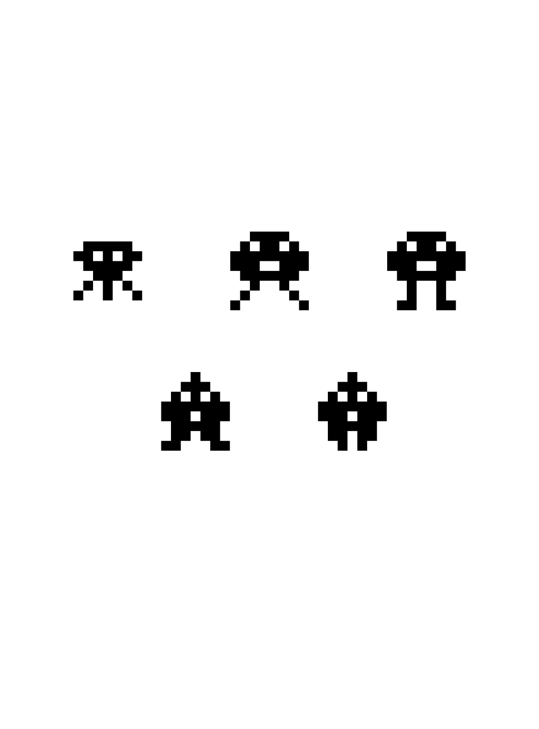

But only the first 5 aliens show up:

@PoP: That's probably #21 .
Will be fixed in the next release .
(For now, you can add bogus padding characters at the end of your string to get stuff to show up).

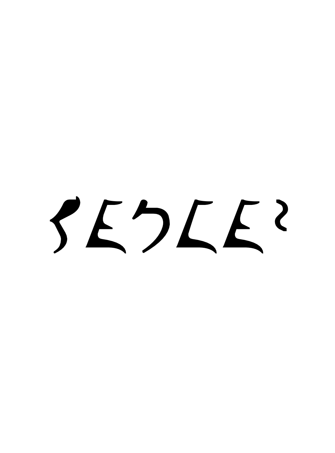

^ Yep
fdsys=/usr/java/lib/fonts/
#Qapla'
fbink -c -t regular="$fdsys"code2000.ttf,size=60 -m -M "          "
screenshot

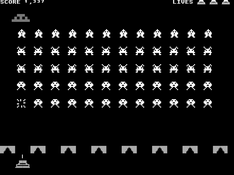

Indeed, no more padding spaces needed:
Remember?
Now revived on my K3!
(Which *will* be a great loss when it dies )
File Type: zip 2018-11-04 SpaceInvaders.sh.zip (976 Bytes, 228 views)
