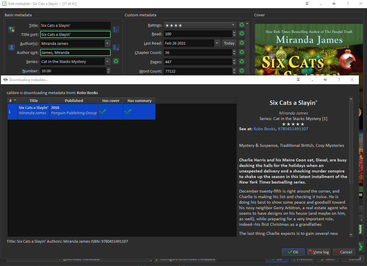

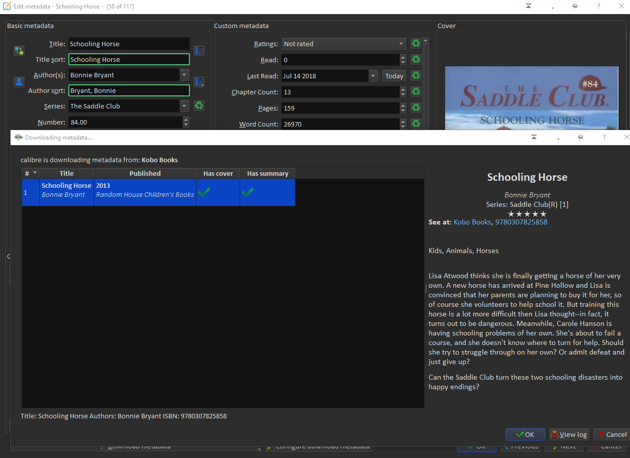

Unchecking all other metadata sources I am able to replicate it:
Name:	2022-04-04 18_10_08-Edit metadata - Schooling Horse -  [58 of 117].png
Name:	2022-04-04 18_11_29-Edit metadata - Six Cats a Slayin' -  [11 of 41].png
("Traditional British"? It takes place in Mississippi...)
