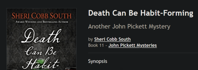

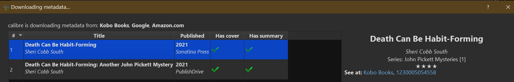

I can confirm the "everything is series number (1)" bug. It has become the norm for books I've bought in series, the most recent was a book I bought 2 days ago. The 1st screenshot shows the book in the Kobo store, the second the listing for that version's ISBN in the metadata import plugin and the third shows the listing for other editions.
It has become so routine that I tend to mix and match the metadata download - I prefer the books to have the covers match the copy I bought from Kobo, but I also prefer not having to continually change the series number.

Unchecking all other metadata sources I am able to replicate it:
Name:	2022-04-04 18_10_08-Edit metadata - Schooling Horse -  [58 of 117].png
Name:	2022-04-04 18_11_29-Edit metadata - Six Cats a Slayin' -  [11 of 41].png
("Traditional British"? It takes place in Mississippi...)
