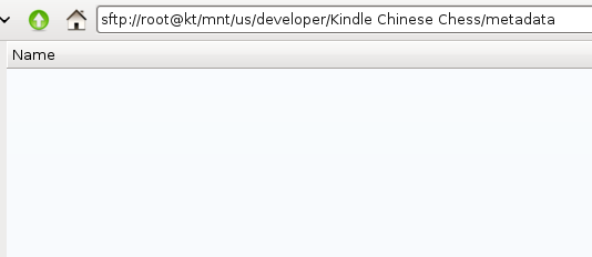

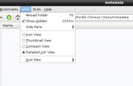

Karma: 6299993
Join Date: Jun 2012
FWIW I too have no folder there.
ID:	103485   Click image for larger version

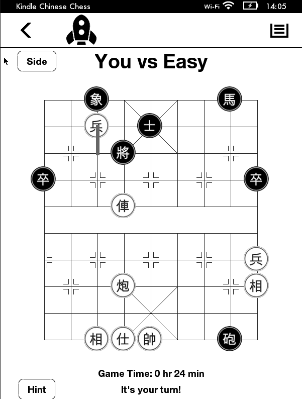

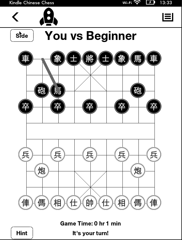

I did find one little "bug?" dunno... In certain - later stages... The HINT button just does nothing (switching sides seems to give it the nudge it needs)
Pictured example.
But mainly AWESOME
Thanks.
