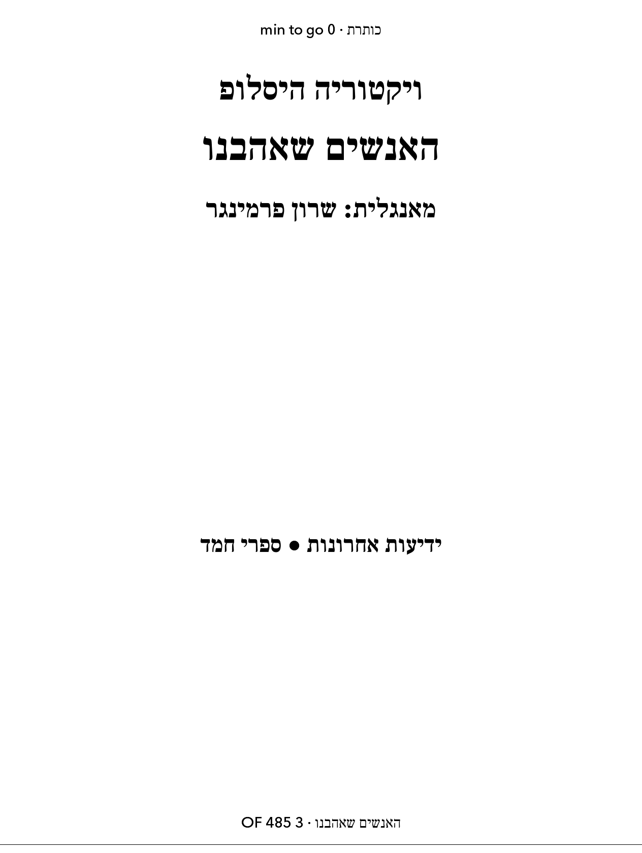

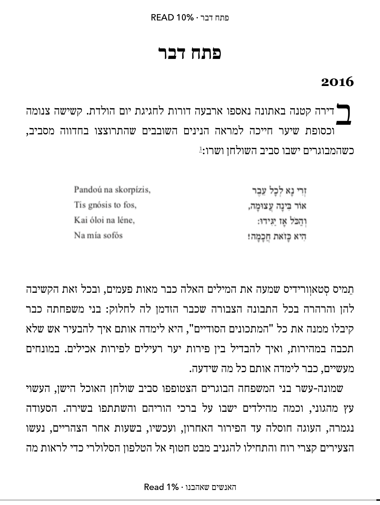

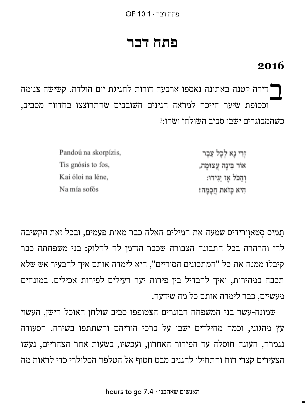

Product: Kobo Libra H2O
Firmware: 4.25.15875
Plugins: none, just made a little config tweak to take the screenshots.
File types: kepub.epub
Sideloaded or from Kobobooks: sideloaded
On external SD: nope
Steps to reproduce:
  1. Just open a book in Hebrew (or, probably, any other right-to-left language) such as Arabic.
Current result:
This is a visual glitch regarding the top and bottom when mixing, it seems, book chapters or book titles in Hebrew with other information in English, such as pages remaining, time remaining, etc. I've attached 3 screenshots with all the 3 different options for head and footer available on the device.
It is usable, just looks unpolished. I imagine something similar will happen with other left-to-right languages, such as Arabic.
I'll, gladly, provide more information or test a fix for this. I check the site regularly, on a daily basis.

Old 01-31-2021, 07:26 AM   #1330
davidfor
Posts: 24,905
Karma: 47303826
Location: Sydney, Australia
You are talking about a mix of information from the book (the title and the chapter name) and the UI (the position information). The latter will always be in whatever language you have the UI set to. Until Kobo adds support for Hebrew or Arabic, it will continue to be like this.
As with all these things, you should report them to Kobo. If enough people ask for support in other languages, they will look at adding it. Of course, it would be much better if there was a company willing to partner with Kobo for the support. That is why most of the recent languages have ben added.
Old 01-31-2021, 07:56 AM   #1331
Colonel Cathcart
Colonel Cathcart ought to be getting tired of karma fortunes by now.Colonel Cathcart ought to be getting tired of karma fortunes by now.Colonel Cathcart ought to be getting tired of karma fortunes by now.Colonel Cathcart ought to be getting tired of karma fortunes by now.Colonel Cathcart ought to be getting tired of karma fortunes by now.Colonel Cathcart ought to be getting tired of karma fortunes by now.Colonel Cathcart ought to be getting tired of karma fortunes by now.Colonel Cathcart ought to be getting tired of karma fortunes by now.Colonel Cathcart ought to be getting tired of karma fortunes by now.Colonel Cathcart ought to be getting tired of karma fortunes by now.Colonel Cathcart ought to be getting tired of karma fortunes by now.
Posts: 244
Karma: 340434
Join Date: Dec 2020
Location: Israel
Device: Kobo Libra H2O
I think the problem comes b/c of missing LTR/RTL markers in the header/footer similar to what's explained here: https://stackoverflow.com/questions/...r-text-in-html. I could be wrong about that.
btw, if I'm not mistaken, Japanese is also written right-to-left.
I have done that, via the email in the OP.
Colonel Cathcart is offline   Reply With Quote
Old 01-31-2021, 08:59 AM   #1332
davidfor
Posts: 24,905
Karma: 47303826
That is almost definitely what is happening. But, it means they have to support this in the UI. Adding it might not make sense to them when they do not support these languages a
But, it is also vertical. And support for the language is in the UI, so they will be looking for whatever is needed in the book.
Old 01-31-2021, 09:22 AM   #1333
Colonel Cathcart
Posts: 244
Karma: 340434
Join Date: Dec 2020
Location: Israel
... when they do not support these languages...
They do support those languages, to a great extent. Hebrew, at least. All the right-to-left book text renders perfectly. Not only that, but also the right-to-left book title and author name on the my books page renders perfectly - it is even right justified as it should. That's more than most products that claim to support Hebrew. This visual bug seems, to me, more of an oversight than an incomplete support for right-to-left languages.
I sure hope they'll fix it, but whether Kobo will fix this in the near future or ever is entirely up to them. I'm just reporting it and hoping for the best.
