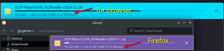

It's definitely related to geo-location or server issue. Works fine on Tor browser or when using VPN but without them it's taking forever to download.

@shuvashish76 Yep. I just downloaded with 3.5MB/s
Still think it's a bit odd that you're complaining about free code download that you'll have to wait half an hour for. Why don't ya grap a coffee? Last edited by Markismus; 02-03-2025 at 05:55 AM. |
