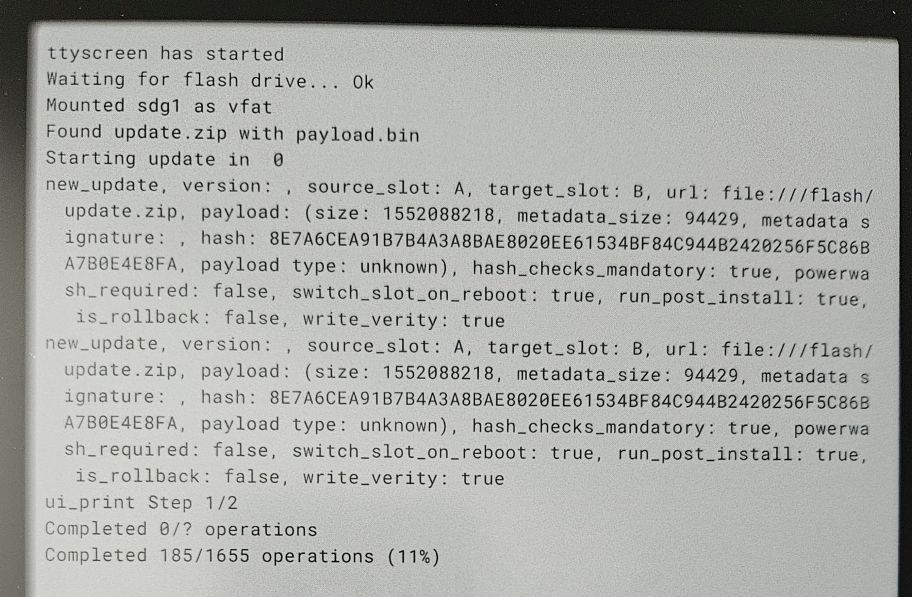

Of course! Happily...
Update started normally and crashed shortly after 11% message appeared (see attached screenshot).
Contrary to the previous versions it did not generate an autolog.txt.

Old 05-12-2024, 02:16 PM   #115
Renate
Onyx-maniac
Posts: 4,299
Karma: 20532355
Thanks!
You mean it froze there and didn't type anything more?
Yeah, I did some changes to make it use a local file and only at the end copy it to flash.
I've never seen update_engine freeze.
That's another vote for you having bad hardware.

Old 05-12-2024, 03:44 PM   #116
Pentam
Pentam began at the beginning.
Posts: 54
Join Date: Jul 2023
Device: Boox Tab Mini C
Thanks!
Yep. Flash LED stop blinking and nothing else happened on the screen. Blue power LED and QUSB detection in device manager.
I guess so too. Warranty process is already started. Let's hope for the best...
