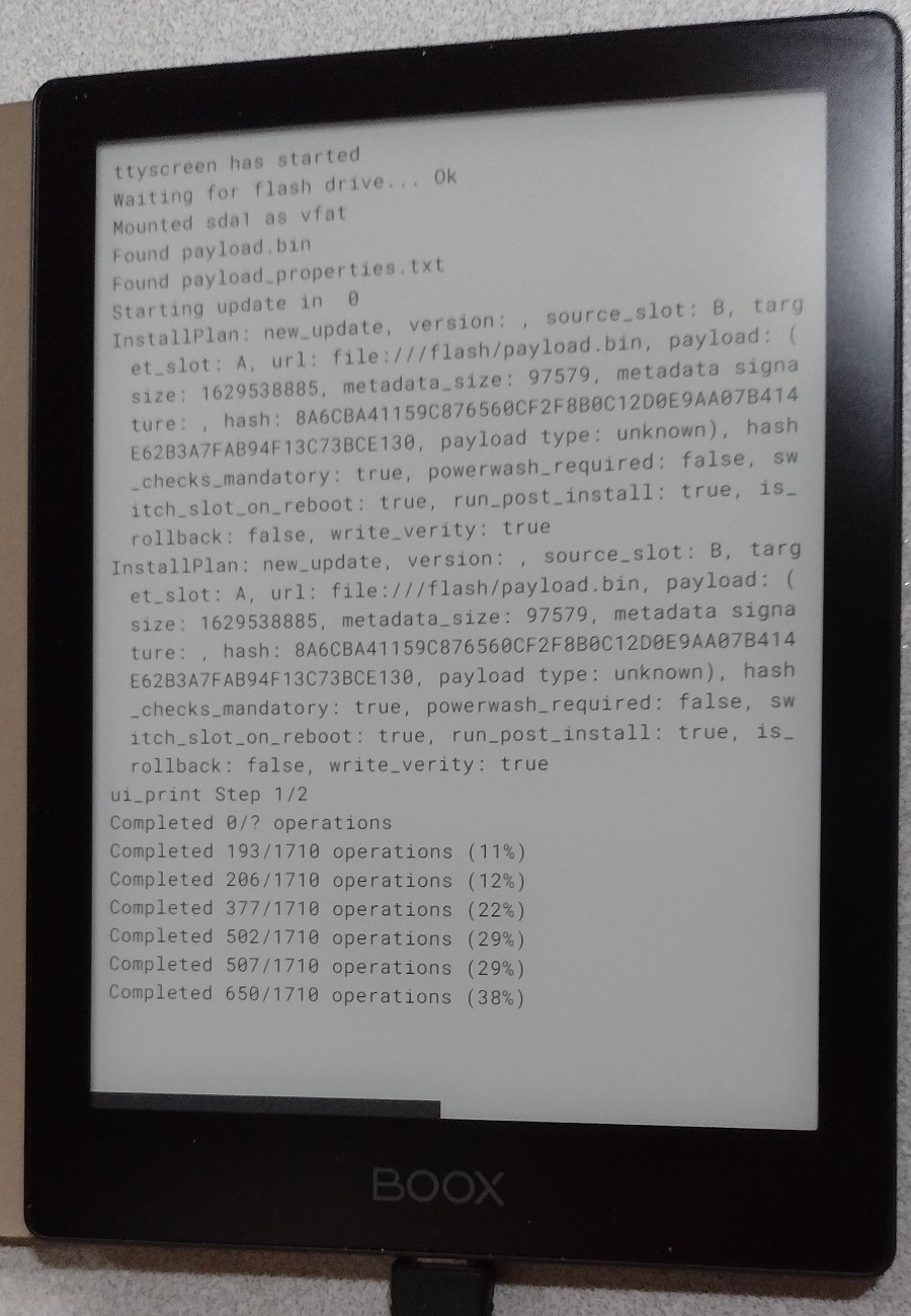

Mmm, could you do me a favor?
Could you try the newest version?
Of course! Happily...
Update started normally and crashed shortly after 11% message appeared (see attached screenshot).
Contrary to the previous versions it did not generate an autolog.txt.
You mean it froze there and didn't type anything more?
Yeah, I did some changes to make it use a local file and only at the end copy it to flash.
I've never seen update_engine freeze.
That's another vote for you having bad hardware.
