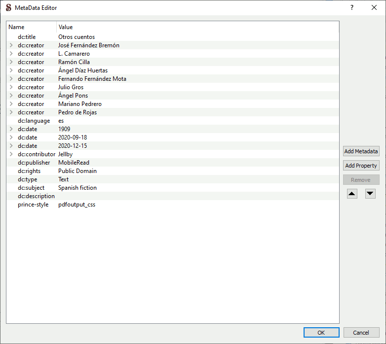

I started thinking more about this but I strongly dislike using a table with columns that are empty or represent more than one thing or or that simply do not make sense for a particular value.
If you split out main title and its file-as, and author (and its file as), language (primary and secondary), and use a big box for description ... you really need two different tables to handle most of the rest:
The first for other creators and contributors with 4 columns:
Marc-Function, Name, File-As, Creator vs Contributor
And the second scrolling table for all other name value pairs with columns:
Name, Value
This can hold all identifiers, all dates, all subjects, rights, formats, additional descriptions, sources, cover, and etc.
Shoehorning things into a single flat table like we did with epub2 just makes no sense to me.
That is why I like our existing MetaEditor. As differing columns just become added properties under the main entry. So the whole thing becomes a list which can be reordered easily and at will and effectively allows a variable number of columns to be available for any specific metadata entry.
So maybe a MetaData starter page with just this:
Title, File-As
Author1, File-As
Author2, File-As
Author3, File-As
Language1, Language2
Big Description Box
With a button to take you to the current MetaData Editor for all else.
Thoughts?
Alternatively we could stay with the current MetaEditor and try to replace all code pieces with translated names but keep the list with added extras approach, but try to do more to hide the code itself.
The actual menus to add Elements in the current, is really not far off the Add Basics we used before.
I just hated the table approach we used before as we just shoehorned various metadata length pieces into those misnamed columns.
Ideas? Thoughts?

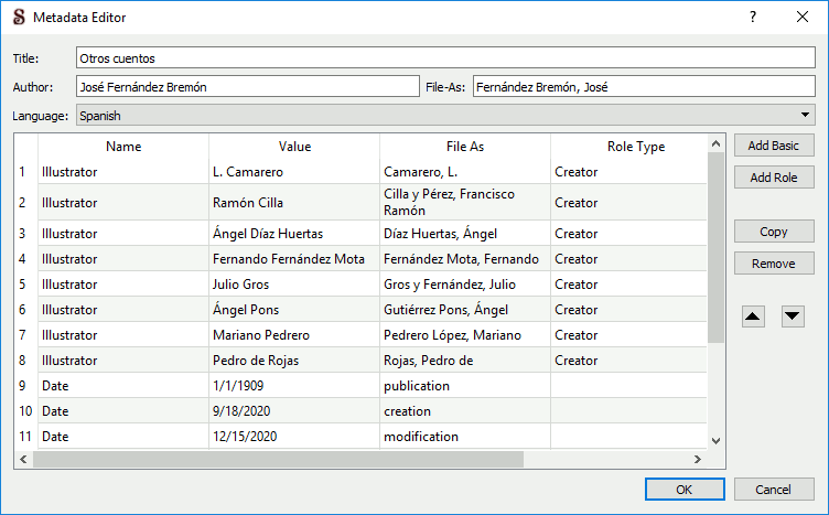

While Sigil has a fully functioning metadata editor, I liked the table-based design of earlier versions better.
Here's a mockup of a table-based metadata editor (based on my epub2 metadata plugin) that I'd like to see in a future version:
(The Title File-As box should be hidden for epub2 books.)
I know that it'll be difficult to create a solution that works for epub3 and epub2 books, but especially new Sigil users will probably prefer a table-based GUI over a tree-based GUI.
There should at least be the 3 mandatory EPUB metadata:
  • Title
  • Author
  • Language
I think these should stand out more prominently + NOT be deletable.
These 3 are also the most common use-case, so making these easy to find/read/adjust is a huge QoL improvement.
Yes.
Here's yet another example I just ran across.
I recently opened up Jellby's latest EPUB:
https://www.mobileread.com/forums/sh...d.php?t=335691
He made extensive use of metadata, but:
dc:contributor   Jellby
      opf:role   bkp
dc:creator       Ramón Cilla
      opf:role   ill
Off the top of your head, can you tell me what those 2 roles are?

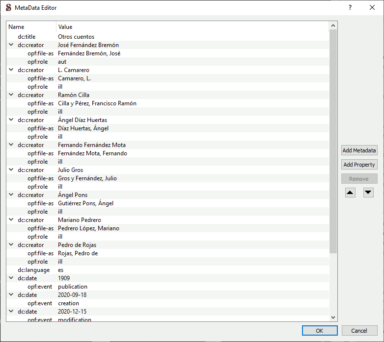

While skimming through Add Property > Role... I'm assuming bkp = "Book Producer".
In that menu, names are human-readable, but no 3-letter code.
And in the main Metadata Editor, it's all 3-letter codes, but not human-readable.

Potential Enhancement #2
Human-readable Metadata Editor.
Remove "code-speak" and replace with human language.
Current:
dc:title        Otros cuentos
dc:creator      José Fernández Bremón
  opf:file-as
  opf:role      aut
dc:language     es
  opf:role      bkp
  opf:role      ill
Potential:
Title           Otros cuentos
Creator         José Fernández Bremón
  File As
  Role          Author

The other thing I do not understand is why people think the current MetaData editor is so bad?
A lot of these QoL adjustments not just help complete noobs, but also helps speed up advanced users.
Take Jellby's EPUB as an example.
Quick! What is the Language of this book?
Okay okay, you finally found it. But what about now?
Okay okay, you finally found it... But what about now?
Ahhh yes, Spanish. And it's right up top!
