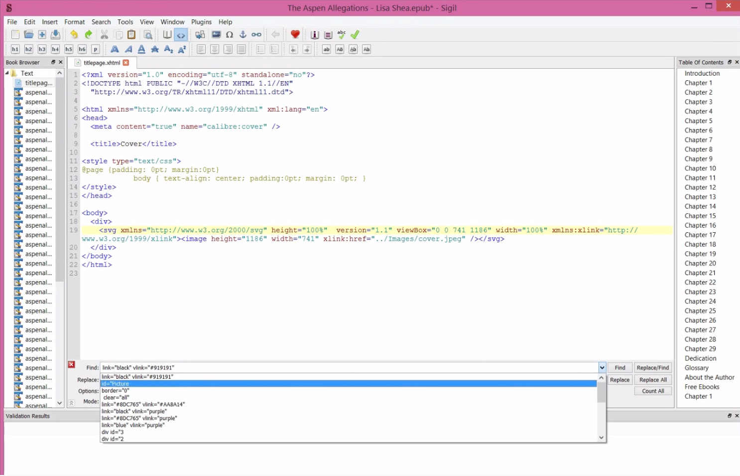

First, any links would have a pair of attributes – link=”color” and vlink=”color – which had to be stripped off. Images would often have a border=0 which had to be stripped. Pictures would have an id=”Picture X” and the space caused a problem, so I stripped out that space. And finally, there would be a clear=”all” in various spots which I had to remove.
The built-in Sigil validation tool easily found all of these problems. I’d run the validator, see which issues were in my particular EPUB, search-and-replace to fix them, and then revalidate it. Once it passed, everything was fine, and my file was good to go.
That no longer happens with this latest version of Sigil.

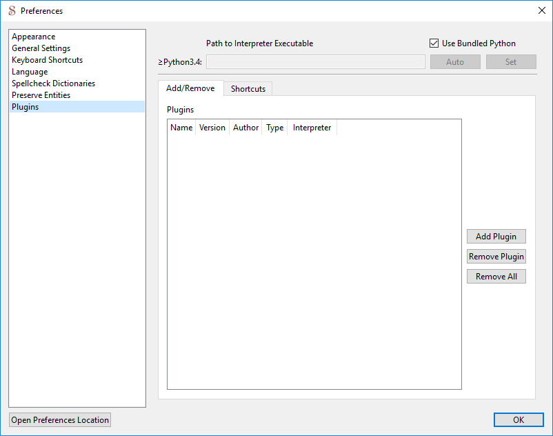

Step 2. In Sigil, press Edit > Preferences > Plugins.
Step 3. Press the Add Plugin button on the right side:
and select the ZIP file you just downloaded.
(In this case, wherever you put the "FlightCrew_v0.9.2win.zip" file. It may exist in your Downloads folder.)

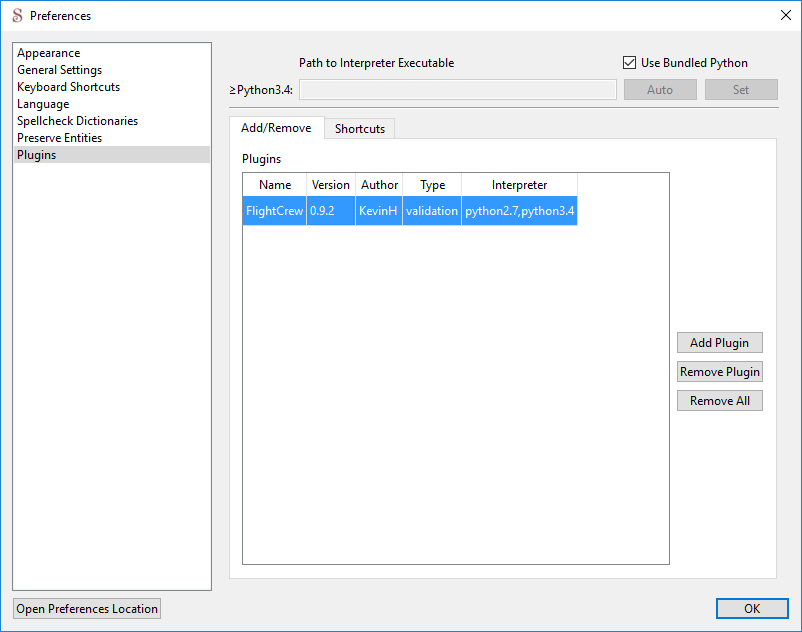

After you add it successfully, FlightCrew should appear in your list:

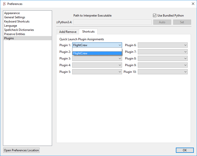

Step 4 (Optional). After FlightCrew is installed, you can assign FlightCrew to one of Sigil's "plugin buttons".
Press the "Shortcuts" tab.
Then click the dropdown for "Plugin 1:" and select FlightCrew:

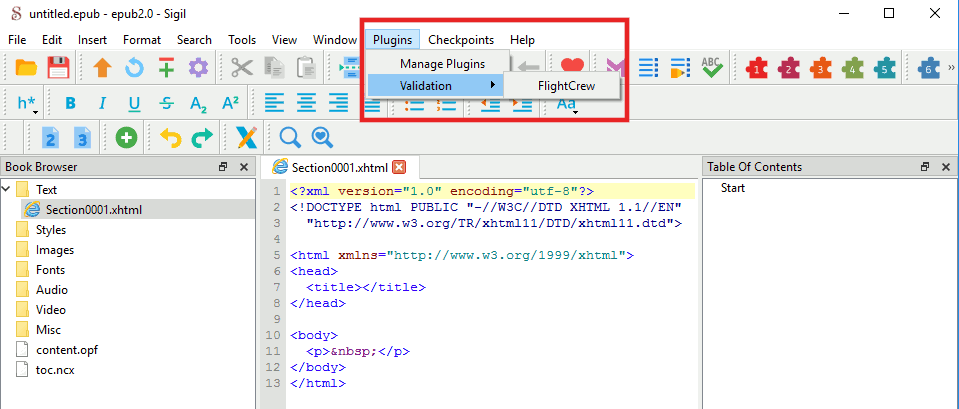

Step 5. FlightCrew can now be found under Plugins > Validation > FlightCrew:

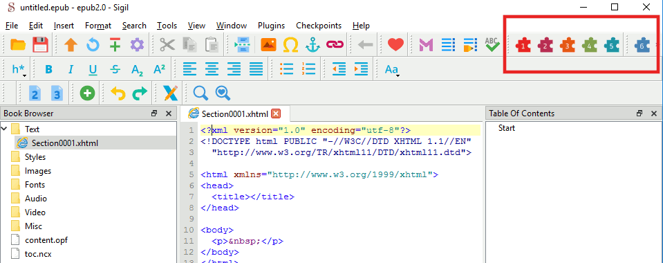

Or, if you followed Step 4, you can press the "Plugin #" button you assigned:
(In this case, the "Plugin #1" button will act like the old "checkmark" button in older versions of Sigil.)
