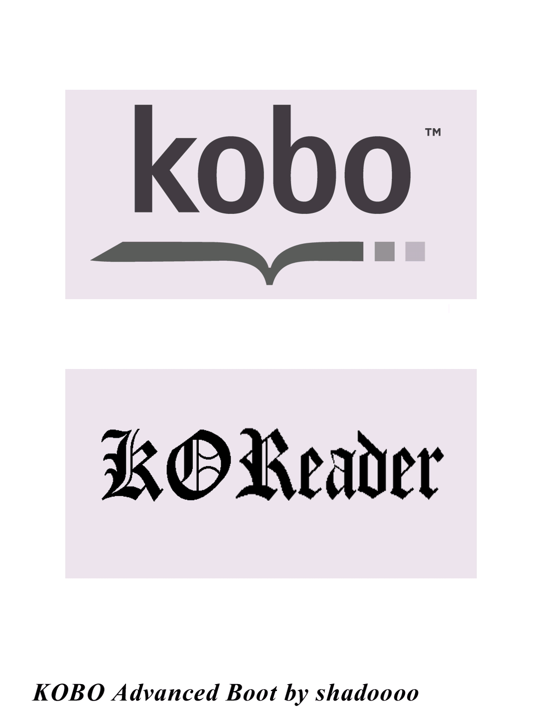

For Kobo Glo HD you can use these settings for ffmpeg. Have a look at attached images too as an example.
raw -> png
ffmpeg -f rawvideo -pix_fmt rgb565 -s 1088x1440 -i <(head -c 3133440 "alyssum-menu.raw") -y "alyssum-menu.png" < /dev/null
png -> raw
ffmpeg -i alyssum-menu.png -f rawvideo -pix_fmt rgb565 -s 1088x1440 -y alyssum-menu-new.raw < /dev/null

Hi Traycold,
(Did you test it on kobo screen afterward ? I ask because I had no problem to decode it to bmp, it’s when reencoding it and trying to display it that it went wrong.)
The sample you provide is working ! many thanks ! 1088 did the trick, obviously.

Hi traycold,
Ok, so I did a mistake. I tried to use your lines to decode the actual raws in the package provided by Shadoooo (the one from this post). Perhaps what I must do is : raws from the package to bmp with the lines provided by tshering, save them in png and reencode them with your lines ? I didn’t try to decode the raw you provided obviously it’s working. I’ll try that this morning anyway.

Originally Posted by cramoisi View Post
Hi traycold,
the raw in the package you mentioned are gzipped. So first of all you have to gunzip them:
gunzip anImage.raw.gz
# you get anImage.raw
Then, consider that the dimension of those images is specific for the dimension of the reader (in fact there is the reader model in the filename), so you have to change the X and Y values when converting to PNG (tip: the raw filesize in bit should be X-dim * Y-dim * 2; so the images for glohd are bigger than those of kobo glo, etc..).
If you want to create images for glo hd, just take any png image you want, change the dimention to 1088 x 1440, convert it to raw and gzip it.
No need to use bpm format.
traycold is offline   Reply With Quote

(of course I did that ) Anyway, I managed to get the png, rotate the files and reencode them. The image files for the gloHD are attached. Thanks a lot to everybody for your help !
