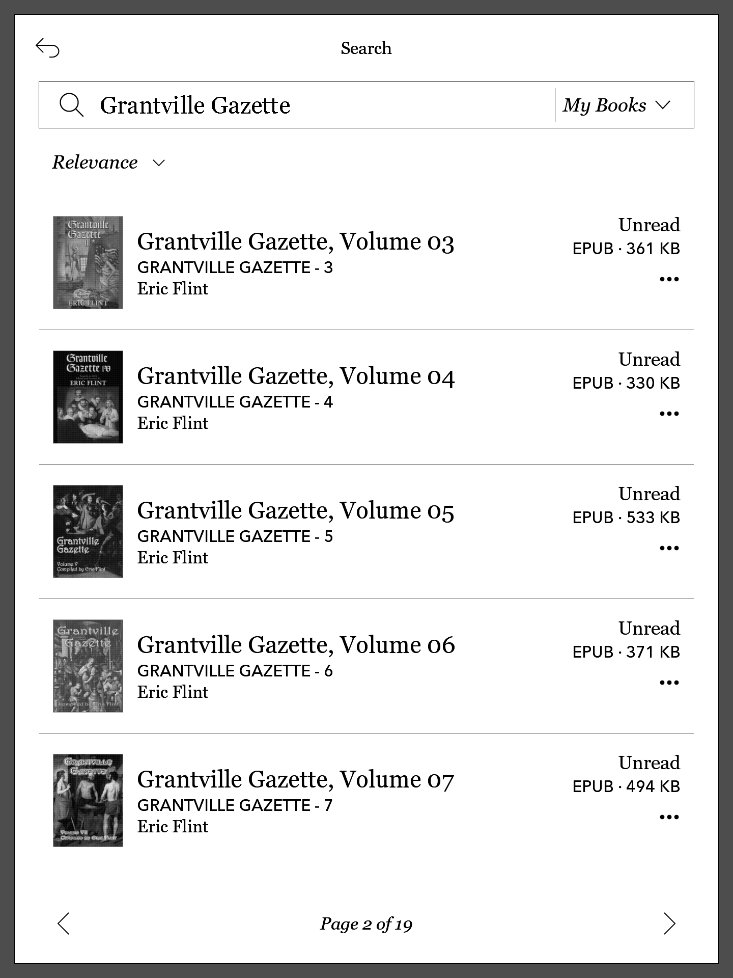

Originally Posted by Semwize View Post
Jon,
I have a suspicion that you have very long series names and they are constantly shortening, so you want to remove the uppercase ... Is that right?
The Kobo GUI shows the series in uppercase. I like this since it makes it easy for me to differentiate between a series and a subtitle. See the attached image for an example.

Old 02-12-2021, 02:03 PM   #97
Semwize
Semwize ought to be getting tired of karma fortunes by now.Semwize ought to be getting tired of karma fortunes by now.Semwize ought to be getting tired of karma fortunes by now.Semwize ought to be getting tired of karma fortunes by now.Semwize ought to be getting tired of karma fortunes by now.Semwize ought to be getting tired of karma fortunes by now.Semwize ought to be getting tired of karma fortunes by now.Semwize ought to be getting tired of karma fortunes by now.Semwize ought to be getting tired of karma fortunes by now.Semwize ought to be getting tired of karma fortunes by now.Semwize ought to be getting tired of karma fortunes by now.
Posts: 932
Karma: 275656
Join Date: Jun 2016
Device: Kobo
I understood perfectly what he wants.
It just seems to me (as to you) that the Series in uppercase looks more correct. If remove uppercase, series will merge with the title of the book.
Can easily write Series in 2 lines, if it's about the length of the inscription.
