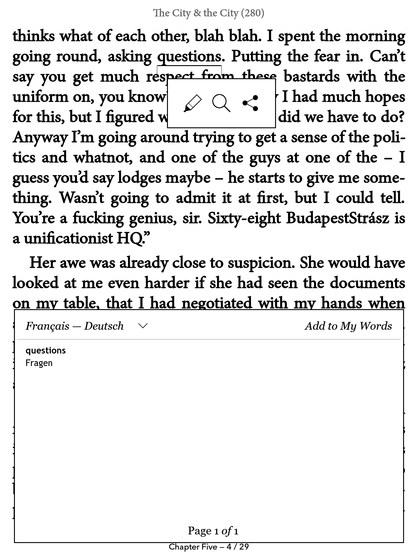

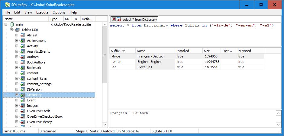

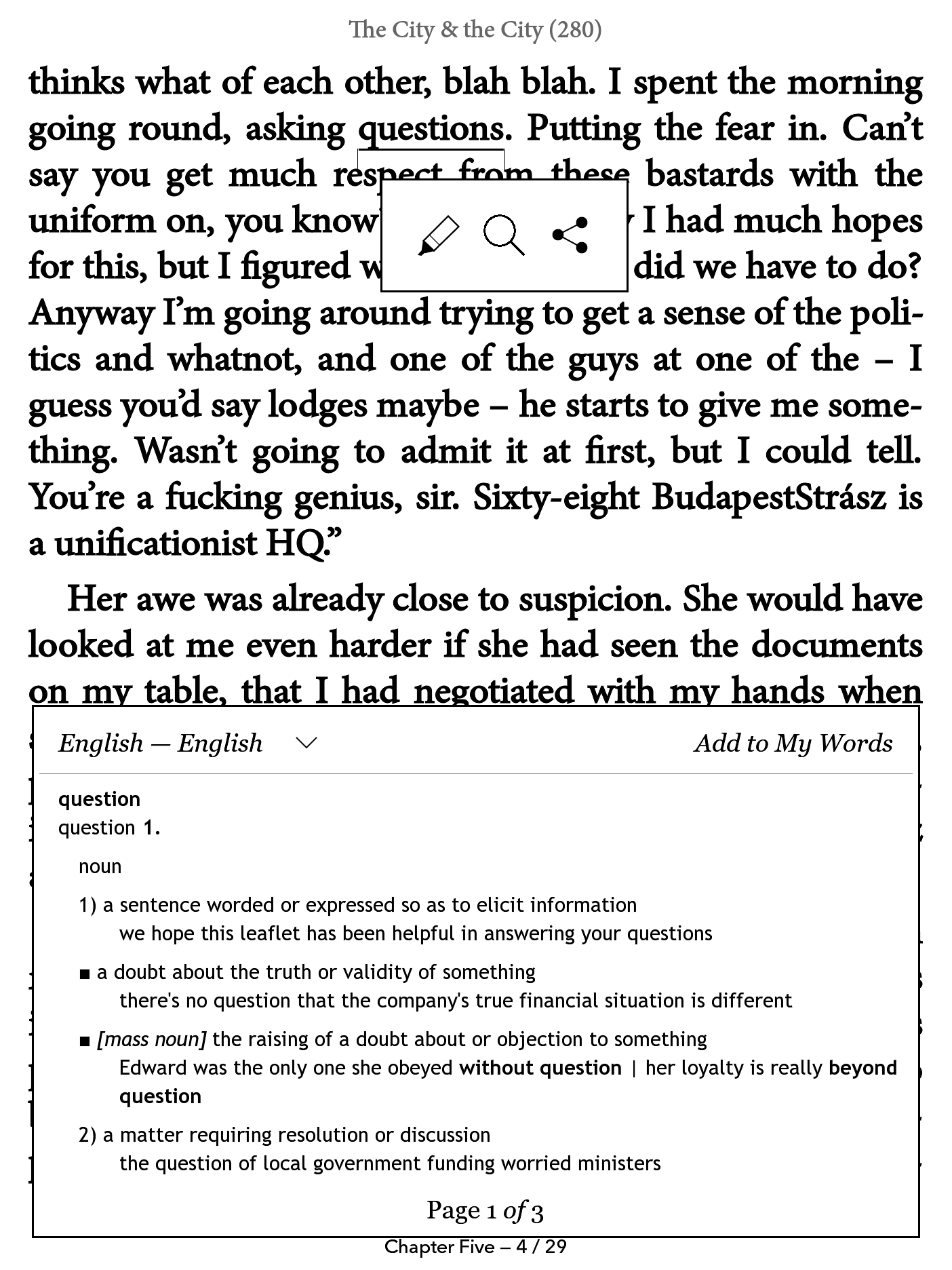

For those having problems with their previously-working custom dictionaries, I think we would need to see the contents of the Dictionary table in your .kobo/KoboReader.sqlite database to be able to help you troubleshoot your problem. I realise this may not be easy if you're not familiar with using an SQLite browse utility (such as SQLiteSpy).
There are multiple ways to install custom dictionaries. Personally I use the most flexible (but most effort required) method described in detail by surquizu here and added to by myself and taos in posts #15,#16,#18 of this thread following problems identified in 4.8.10956. However, I've just tried the 2 easier methods mentioned earlier in this thread (by those having problems since the firmware upgrade) to install:
  • a second custom Eng-Eng dictionary - by adding a dicthtml-en-en.zip file to the .kobo/dict directory
  • a custom French-German translation dictionary - by adding a dicthtml-fr-de.zip file to the .kobo/dict directory
In each case I needed to add an extra row in the Kobo database's Dictionary table. I'm not sure how you originally did your custom dictionary installs, but I'm wondering whether the necessary entries in this table were removed during your firmware upgrade.
As you can see below, both of these custom dictionaries are successfully looking up the selected word.
I have also attached a screenshot of the relevant rows (the first two) in the Dictionary table to show what a successful entry looks like.

Regarding the dictionaries, I just checked for the French - German dictionary anacreon mentioned:
1.) Copy the dictionary file to .kobo/dict -> reboot -> there's no entry in the drop-down menu for the dictionary look-up.
2.) Then add the dictionary to the KoboReader.sqlite database in the Dictionary table under a "wrong" name ("French - German") -> save the database -> reboot -> there's now a "French - German" entry in the drop-down menu -> choose this dictionary -> error: "You don't have a English dictionary installed."
3.) Now change the name in the Dictionary table of the database to the correct name ("Français - Deutsch") -> save -> reboot -> there's now a "Français - Deutsch" entry in the drop-down menu -> choose this dictionary -> no error, look-up works without a problem

Originally Posted by anacreon View Post
This is what I wanted, and I found sqlitespy and downloaded it. But I can't find any tutorial on how to create new lines (I need 2) or copy lines and modify them.
Not a tutorial, but it's the best I can do Using the image 3, from my previous post, as a reference...
  1. Double-click on the Dictionary entry in the left column to display the contents of the current Dictionary table.
  2. In the top right box where image 3 shows select * from ... type
    insert into Dictionary values('-fr-de','Français - Deutsch','true',1594055,'','true')
    N.B: the value 1594055 needs to be the exact size of your dicthtml-fr-de.zip file in bytes.
  3. Once you have constructed the above SQL command with the correct size value, press [F9] to run it (or using menu Execute > Execute SQL).
  4. Check your result, if successful, the Dictionary table will have closed. Repeat step 1 to view it again. Your new row will be displayed - probably as the last row.
I recommend making a copy of the database on your PC first so you can practice running an SQL command.
Alternatively, if the above is too confusing it may be worth having a look at the different SQLite utility used by surquizu in the post I linked in my previous post. It looks like it might be more of a "fill-in-the-boxes" way to add a new row.
