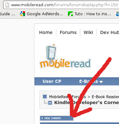

list of stuff...
Okay well.. make a new thread "Pictured"
List of supported devices...
There is already anecdotal evidence to say which releases work on which revisions. And if we get it wrong you can BE SURE someone with mention it.
but yeah. I will do my best.
Also I'm a moderator so with your permission I can just edit your posts anyways.

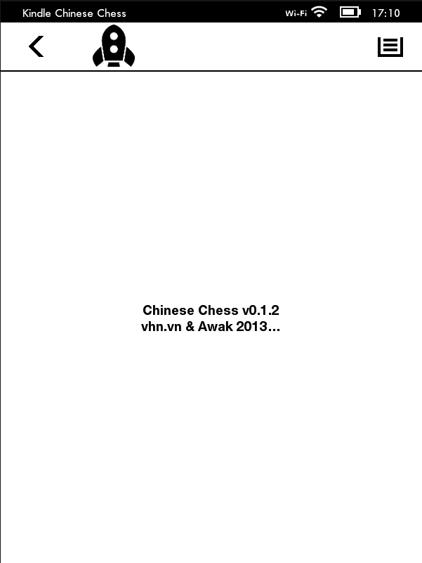

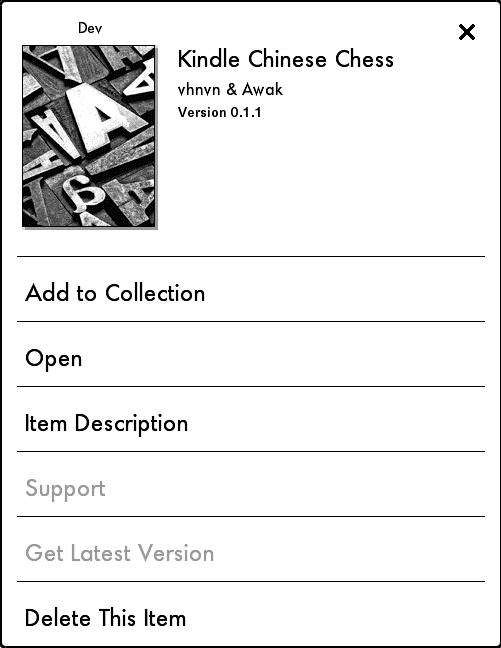

Failure to launch.?
and you forgot to update the version string again?
(1.1 is shown on long press more info?)
I'll try a reboot..
EDIT: Didn't help
[23/03/2013 17:24] Kindle Chinese Chess (v. 0.1.1)
java.lang.NullPointerException: null
at com.amazon.kindle.kindlet.internal.security.Kindle tSecretKey.ZDb(euc:937)
at com.amazon.kindle.kindlet.internal.security.Kindle tSecretKey.Fgb(euc:614)
at com.amazon.kindle.kindlet.internal.security.G.Fgb( vrc:1410)
at com.amazon.kindle.kindlet.internal.security.G.ieb( vrc:773)
at com.amazon.kindle.kindlet.internal.security.G.OEb( vrc:1320)
at com.amazon.kindle.kindlet.internal.security.G.getC hars(vrc:1333)
at vn.vhn.amazon.kindle.chinesechess.posCollection.lo calIsSolved(Unknown Source)
at vn.vhn.amazon.kindle.chinesechess.posCollection.po pulateSolvedArray(Unknown Source)
at vn.vhn.amazon.kindle.chinesechess.posCollection.<i nit>(Unknown Source)
at vn.vhn.amazon.kindle.chinesechess.Main$1$1.run(Unk nown Source)
at java.awt.event.InvocationEvent.dispatch(Compiled Method)(Unknown Source)
at java.awt.EventQueue.dispatchEvent(Compiled Method)(Unknown Source)
at java.awt.EventQueueProxy.dispatchEvent(Compiled Method)(Unknown Source)
at java.awt.AGUIEventDispatchThread.pumpOneEventForHi erarchy(Compiled Method)(Unknown Source)
at java.awt.AGUIEventDispatchThread.pumpEventsForHier archy(Compiled Method)(Unknown Source)
at java.awt.AGUIEventDispatchThread.pumpEvents(Unknow n Source)
at java.awt.EventDispatchThread.pumpEvents(Unknown Source)
at java.awt.EventDispatchThread.run(Unknown Source)
at java.lang.Thread.startup(Unknown Source)
Ill try updating the dev certs from https://www.mobileread.com/forums/sho...9&postcount=90
EDIT: Nope... still didn't work.
Hmm... Maybe I'll just go get your source code and build it myself.
DOH! you didnt push it up
Here my efforts end. sorry

Sorry, my mistake - I forgot to update the manifest file. Just too tired and easily to make mistakes...
Don't know why my kindle doesn't complaint...
Please replace the following attachment with previous one to avoid confusion. Thanks!
Please test it again quickly - I really need to sleep soon..
File Type: zip KindleChineseChess-touch.0.1.2 (good).zip (223.0 KB, 173 views)
