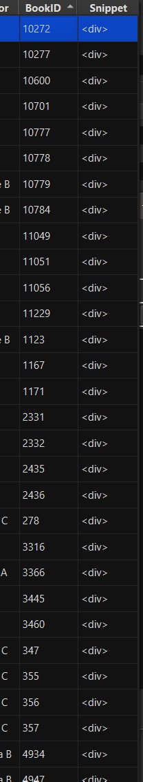

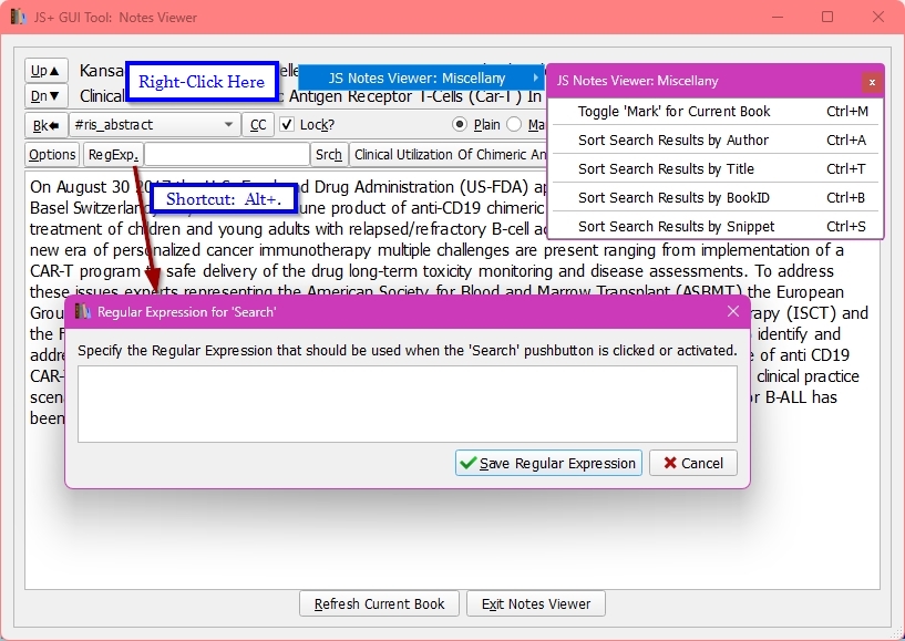

Thanks for the changes.
Sorting on BookID should be numeric, see attachment (note the Snippet - maybe it should be first two lines if first is very short - without the line feed).
I'd also prefer to set and forget a default Sort sequence - for me it would be BookID ascending. Ditto with AJ - which for me would be checked.
The RegExp field doesn't appear to have a 'Alt+' shortcut
The following error can also occur if the user does a NV search and then does a book list search that takes NV search results out of sight. You might want to add " or you did library search, or clicked a VL tab". I hit Alt+A in the book list which does a search for current author
calibre, version 6.15.0
ERROR: Notes Viewer: Book does not currently exist. Either you recently deleted it, or you are using a Virtual Library that does not contain it.

Version 1.0.228 Notes Viewer: Various enhancements
Version 1.0.228 -2023-04-07 Notes Viewer: Various enhancements. Refer to the attached images for details.

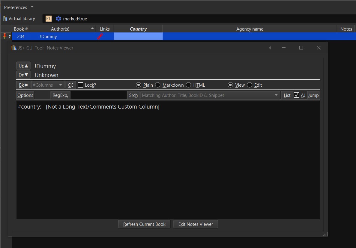

Why does NV react to what I do in the book list, viz:
Name:	Screenshot 2023-04-08 163002.jpg
Country is a Text like tags column.

NV is joined at the hip with the Library View. Its driver is a Library View event that is emitted whenever the current cell changes.
self.maingui.library_view.selectionModel().currentChanged.connect(self.refresh_notes_viewer)
I will take your question as an indication that NV is very non-mouse-user friendly. That question would never occur to a pure mouse-user, like myself, who doesn't use shortcuts.
