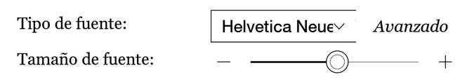

Originally Posted by JIPG-reader View Post
In the menu to change fonts, the rectangle that surrounds the name of the font, now is open:
Attachment 161096
Note: The reader GUI is in spanish, and the firmware is the last one 4.7.10413.
That isn't happening here in either English or Spanish. But, you appear to be using a sideloaded font, and the advanced font setting option is showing. That means you have patched the firmware to allow this option. In that case, I don't consider this to be a bug in Kobo's software.

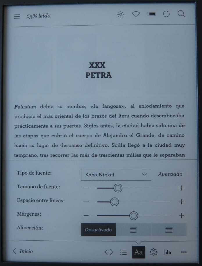

In addition to what davidfor said, have you also enabled 'Large Print Mode' in the Beta Features? If so, maybe that's one of the reasons why it is beta

OK, as I had no camera on hand, I used a picture from other guy that I thought had the same problem. I was trying to show graphically the "defect" (in fact, it does not bother to much).
I had this problem from the beginning, and without any patch.
I have no patches related to fonts, nor "large print Mode" enabled, but some fonts sideloaded. With the fonts sideloaded, the "advance" option does not appear. The problem only appear with the built-in fonts.
If you have some hints, I can try to check any option you can consider the culprit of this behaviour.

@JIPG-reader: In that case, you are definitely seeing something wrong. I tested on the original Aura H2O and would have expected them to be the same for this (same screen size and resolution). I'll have another fiddle and see if it I can get it to happen. Or I'll borrow my Dads Aura H2O2 when I see him. Leaving it in Spanish should be a bit of fun. But, it would also mean a "support" call, so maybe not.
Thank you davidfor!.
I do not want to put you in trouble with your parents! . Just only if you can guess a reason (maybe the margins?) that can produce this behaviour is more than enough .
Actually I have a patch to reduce the maximum width of the margin (the original one made the zone of text to appear just a "thin column"), but it should not affect, and if I remember well I had the problem before patching. The margin slider is near 50% but without the patch it should be closer to the left, just three steps.
I have only a few patches: the time showing the clock, the one to reduce the maximum width of the margin and the one to solve the problems of kepubs in full screen.

No problem with 4.7.10364 installed in Aura One but it happens with 4.7.10413 installed in Aura Ed 2. No font patch neither 'Large Print Mode'. Both readers are in Spanish.
No problem with 4.7.10413 installed in Aura One (with the same patches than Aura Ed 2 or without them).
I haven't had a play with it at all, and haven't touched one outside the shop. So, I'll test this while I'm doing that.
I doubt those patches are affecting this. And as Terisa is seeing it on another device, it probably means that it's something different about the Mark6 devices. I'll try it on an Aura ONE if I can get it out of my wife's hands. She doesn't seem to remember that I lent her mine so she could decide if she wants one.
