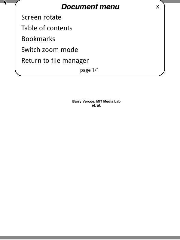

All fixed up now. although thomass advises that the latest build still has an issue or two with menus... (although I just tested the latest nightly on mine and the menus seem to show up fine? even after 4 re-starts [pictured]) Am I misunderstanding the problem?
Many thanks for the tips on the link

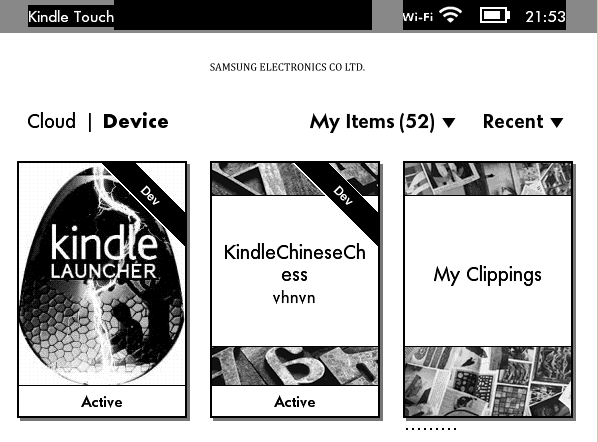

is it the age old... "pillow thingy not show after close" that is the problem? [pictured] caused by the eips file selection menu??
is that the problem?
personally I do a restart pillow and be done with it
this menu is OK. Problem exist on the menu which should be active on the file manager screen. (after using the "return to file manager" item on this list. ) .
ie follow this steps:
  1. using KUAL> use this item: open KPV on documents
  2. see that there is a menu on the top of the file manager (has the title:"Home Menu")
  3. open a document
  4. return to the file maneger using "return to file manager" item of the "Document menu"
  5. try to open the "Home Menu" again
(13-61st lines of the reader.lua )
thomass is offline   Reply With Quote

hmm yeah.
I notice that the status bar keeps peeping through. and that the area assigned to the click is also the area assigned to the status bar...
I dropped the killall -stop cvm back into my kpdf.sh (clearly a bit risky but meh I'm testing and I can use ssh access to restart it in the event of EPIC FAIL)
now my menu works every time.
don't suppose it could be the click is getting swallowed up?
anyways.
I see your point and can now replicate. also can make the issue go away as indicated.
TBH.... I would be comfortable with monitoring the HOME key and simply assuming that a HOME key click was a request to QUIT.
That would be fine. Also, that being the case, one could then drop the relevant pillow/home search bar "tidy up" bits at the kpdf.sh script end.
I should set aside some time to test but I have next to no time right now.
thanks for the heads up
Csound, eh?
