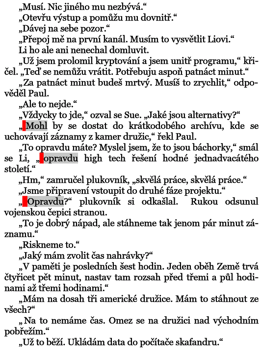

Strange spaces after opening quotation marks
Strange spaces appear after Slovak/Czech opening quotation mark when paragraph justification is set to the justify (whole). This problem is obvious when the spaces between the words are large. Please look at the red rectangles in the attached picture. The selected parts of the source text (e̶p̶u̶b̶ kepub) from which the screenshot was taken is also attached.
File Type: txt screen_001.epub.txt (769 Bytes, 182 views)
helour is offline   Reply With Quote

Actually that book is kepub and not ePub. What happens if you don't convert to kepub?
Sent from my Nexus 7 using Tapatalk

Books in the epub format look fine
Thanks for your comment. The book is really in the kepub not epub format.
Weird spaces do not appear in epub format, everything looks normal. Problem is only for books in the kepub format.
The kepub renderer has some problems with justification. It tends to add extra space around some punctuation when it shouldn't. The main times I see it is around emdash and endash. Your screenshot seems to suggest that there is a problem with other characters. The only lines with extra spaces after the quotes are lines that have a lot of extra spaces added by the justification. I doubt there is anything you can do except turning off justification. And reporting the bug to Kobo.
