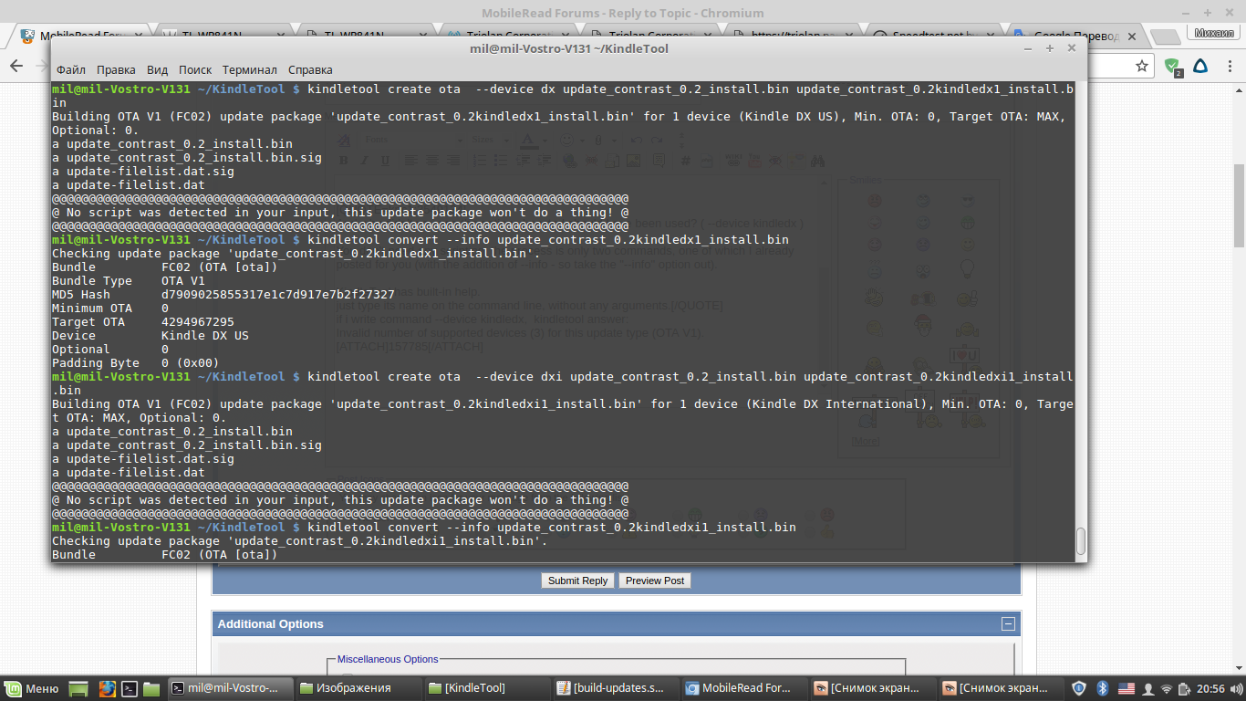

I tried to make a package for kindle dxi
my script in kindletool, upd is extract package folder
Can you check it? Please?
Name:	Снимок экрана о.png

I have no interest in modifing my Kindle DXI -
Why don't you try it?
Why didn't you convert it to a compressed archive rather than extract all the files like you did?
You could have then used KindleTool to repackage that exact same compressed archive without any chance of something going wrong with its contents.
And why didn't you use the options I posted should have been used? ( --device kindledx )
You don't need any scripting, the process is only two commands, one of which I already posted for you (with the addition of --info - so take the "--info" option out).
KindleTool has built-in help.
just type its name on the command line, without any arguments.

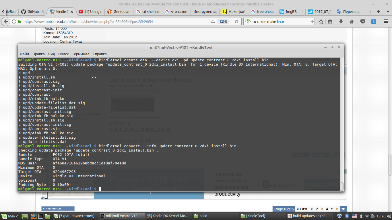

like this:
"kindletool create ota --device dxi update_contrast_0.2_install.bin update_contrast_0.2kindledxi1_install.bin"

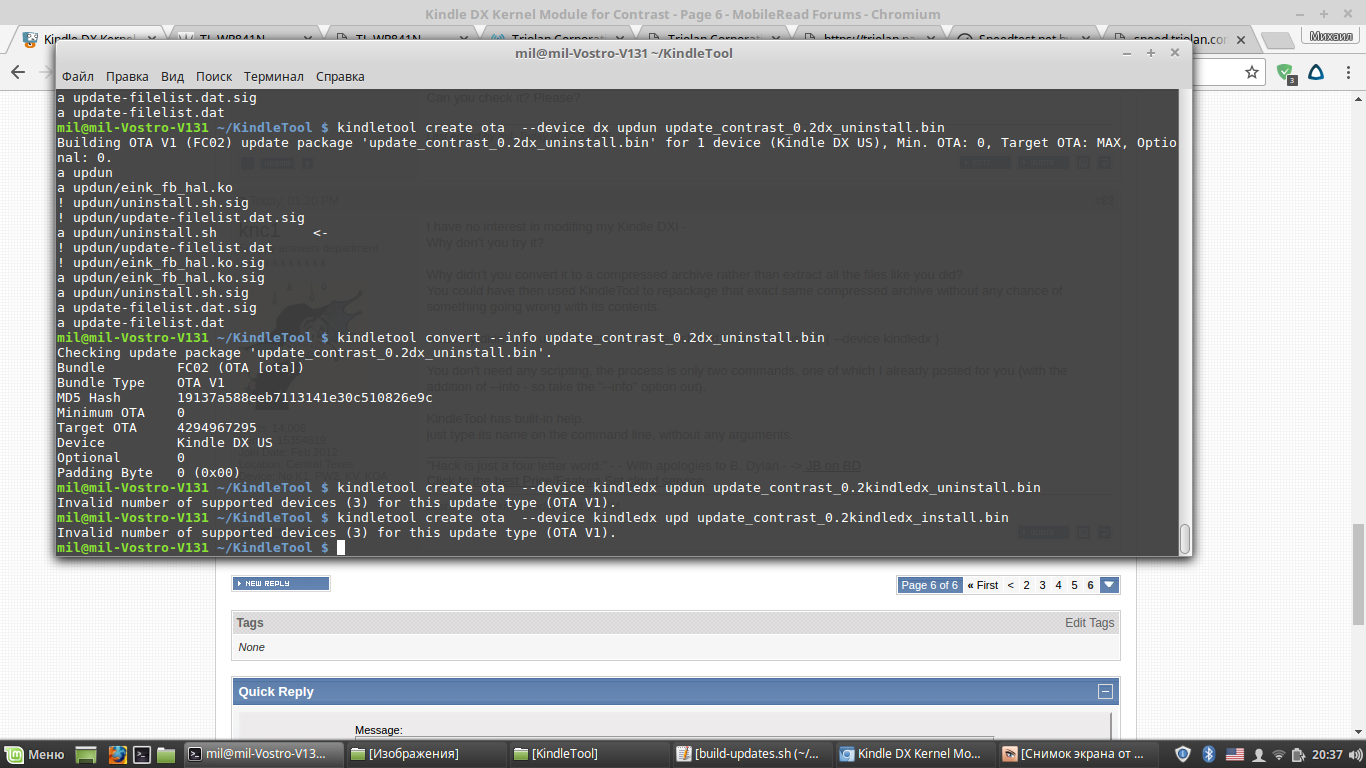

if i write command --device kindledx, kindletool answer:
Invalid number of supported devices (3) for this update type (OTA V1).
Name:	?????? ?????? ?? 2017-07-07 20-37-09.png

You were right with only 2 commands. Thank you dear knc1 !
1. kindletool convert <input>
2. kindletool create
https://youtu.be/tGAHBw3Qo1k
update_contrast_0.2dxi_install.bin
