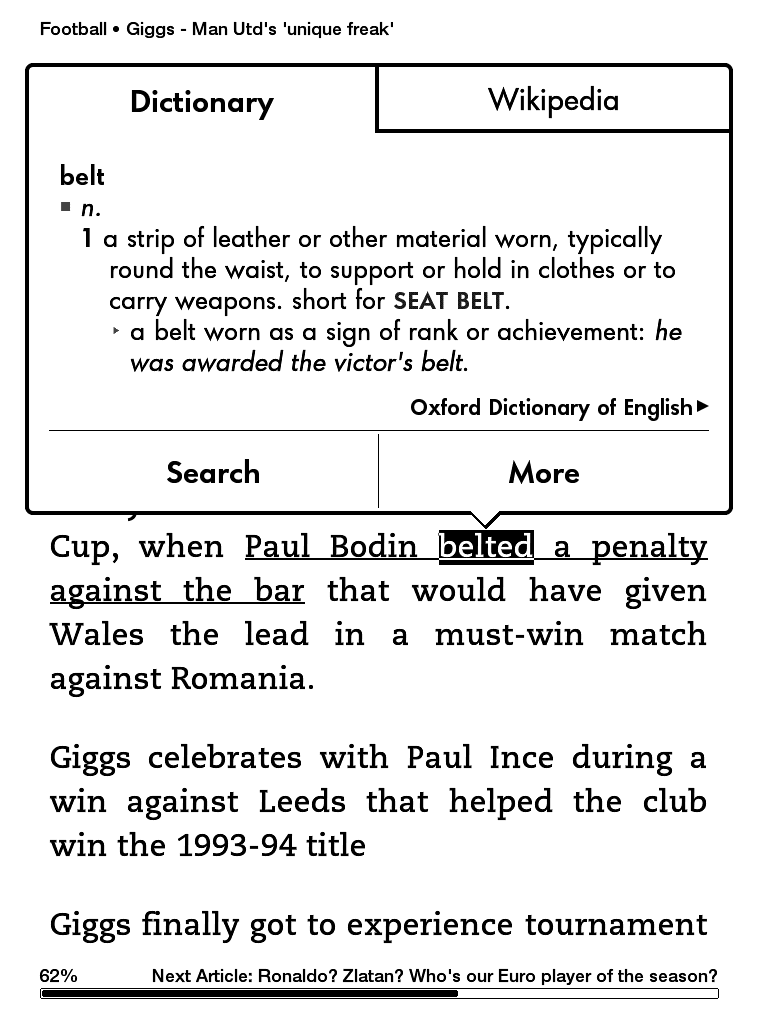

Sometimes, tapping on the past participle of a verb, the look-up dictionary gives me the meaning of the noun only. Forgetting the verb one. This peculiarity happens from time to time, not always. Generally, as you know, there are those arrow keys which allow you to flip through the different meanings. Or the various definitions are one below the other and you have just to scroll the bar. But, every now and again, the arrow keys disappear, preventing you that. This happens with past participles only. In consequence, I am forced to go to ”more”, ”open dictionary” and find the meaning by myself. That’s quite irksome! And a waste of time, as well.
I was wondering if it’s possible — through a hack, maybe— to keep those arrow keys permanently there.
I’ve attached a screenshot as an example.
Thanks!

Originally Posted by JacquesTati View Post
Sometimes, tapping on the past participle of a verb, the look-up dictionary gives me the meaning of the noun only. That’s quite irksome! And a waste of time, as well.
Unfortunately, the resolution of inflected word forms is hard-coded in the dictionary and couldn't be changed by a hack.
You could only change this behavior by installing a different dictionary. Maybe one of the Collins dictionaries is better suited for your needs. However, they got mixed reviews.
Thanks, Doitsu.
I hope they’ll fix it in the next update.
