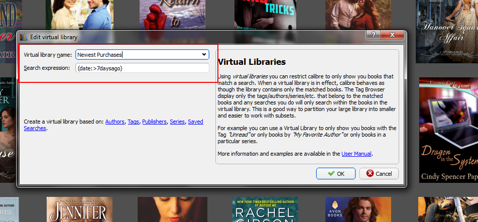

For everyone in the dark . . . .

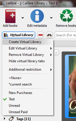

Click on Virtual Library
Select Create Create Virtual Library
In the popup name your VL in the Virtual Library Name field
Enter Search Expression as shown in the attached image.
To filter out freebies, it will depend on how you flag them. I personally have a cost field so I filter out everything <$0.05. If you have another field let us know what it is and I'll see if we can't figure out what expression you should use.
ID:	111853   Click image for larger version

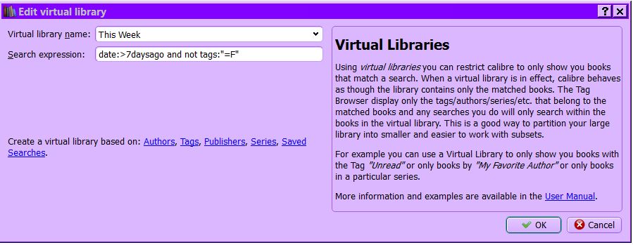

Click Create Virtual Library
Virtual library name field = (type a name)
Search Expression Field = date:>7daysago and not tags:"F"
Click OK.
ETA: I see Apesmom types faster than me
