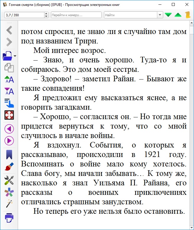

I think we are at a point were we need to see a sample book. Or, you can try one. Attached is a screenshot taken from https://www.mobileread.com/forums/sh...d.php?t=178155 on my Glo HD. The margins are even.

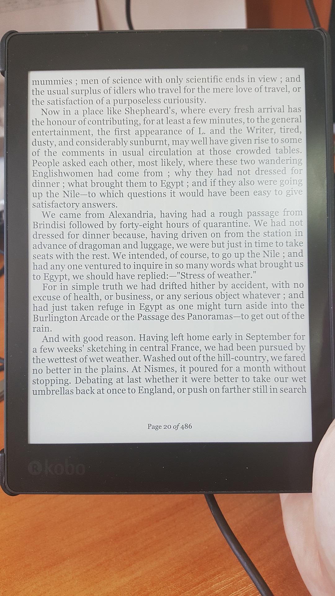

On your book, the indents are the same.
Try and you my book...
File Type: epub KKKristi_Gonchaya-smerti.159159.fb2.epub (318.2 KB, 225 views)

I may have just figured out the problem. Turn off the ADE page numbers in the right margin. They could be causing the problem.
Go to SETTINGS and then READING SETTINGS and uncheck SHOW ADOBE EPUB PAGE NUMBERS:.
I have long since turned off this setting. It does not affect.
Just checked again with a reboot even.
P.S. Now I'm beginning to think that the problem is in Russian lang ...

No, you didn't turn that off. In your lost photo, there is a clear number 21 in the right side of the screen.

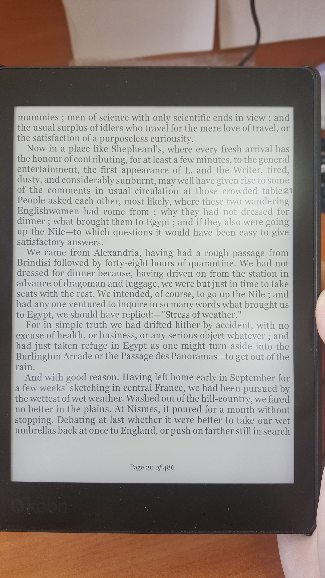

I agree. I forgot to turn it off after the morning reset and update. But still does not affect ((
ID:	155868   Click image for larger version

@ssurneed,
The problem is the HTML for each of your chapters has
<body class="z">
and the matching CSS style is
.z {
	font-family: 'Times New Roman', serif;
	margin-right: 8pt;
Consequently your right margin is larger than your left.
Either remove the red line or change the CSS to
.z {
	margin-left: 0;
        margin-right: 0;
ETA: ... and my advice, if you don't like the ebook styling as provided by the ebook vendor, your best option is to learn a little HTML/CSS so you can fix this sort of problem yourself.

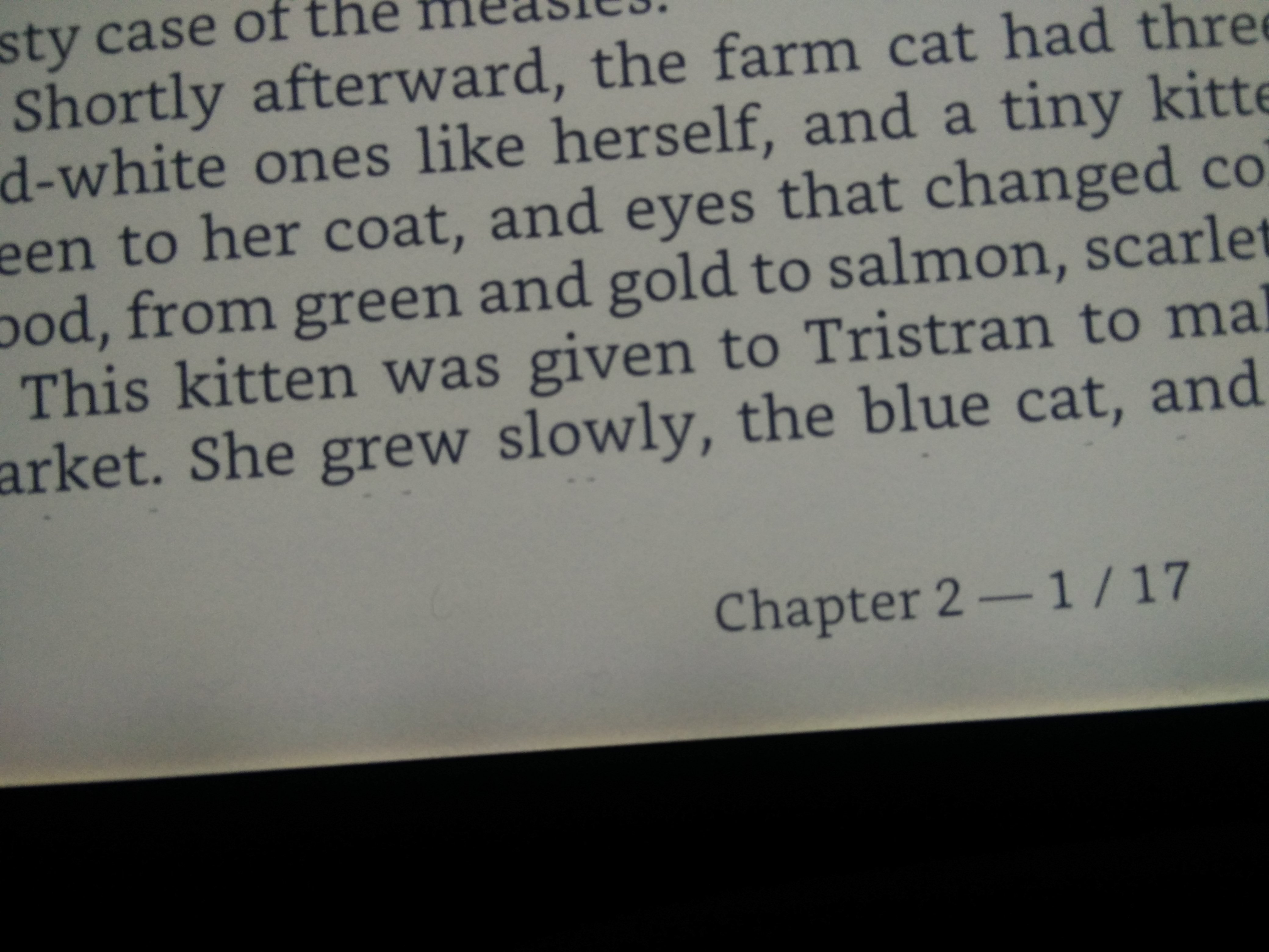

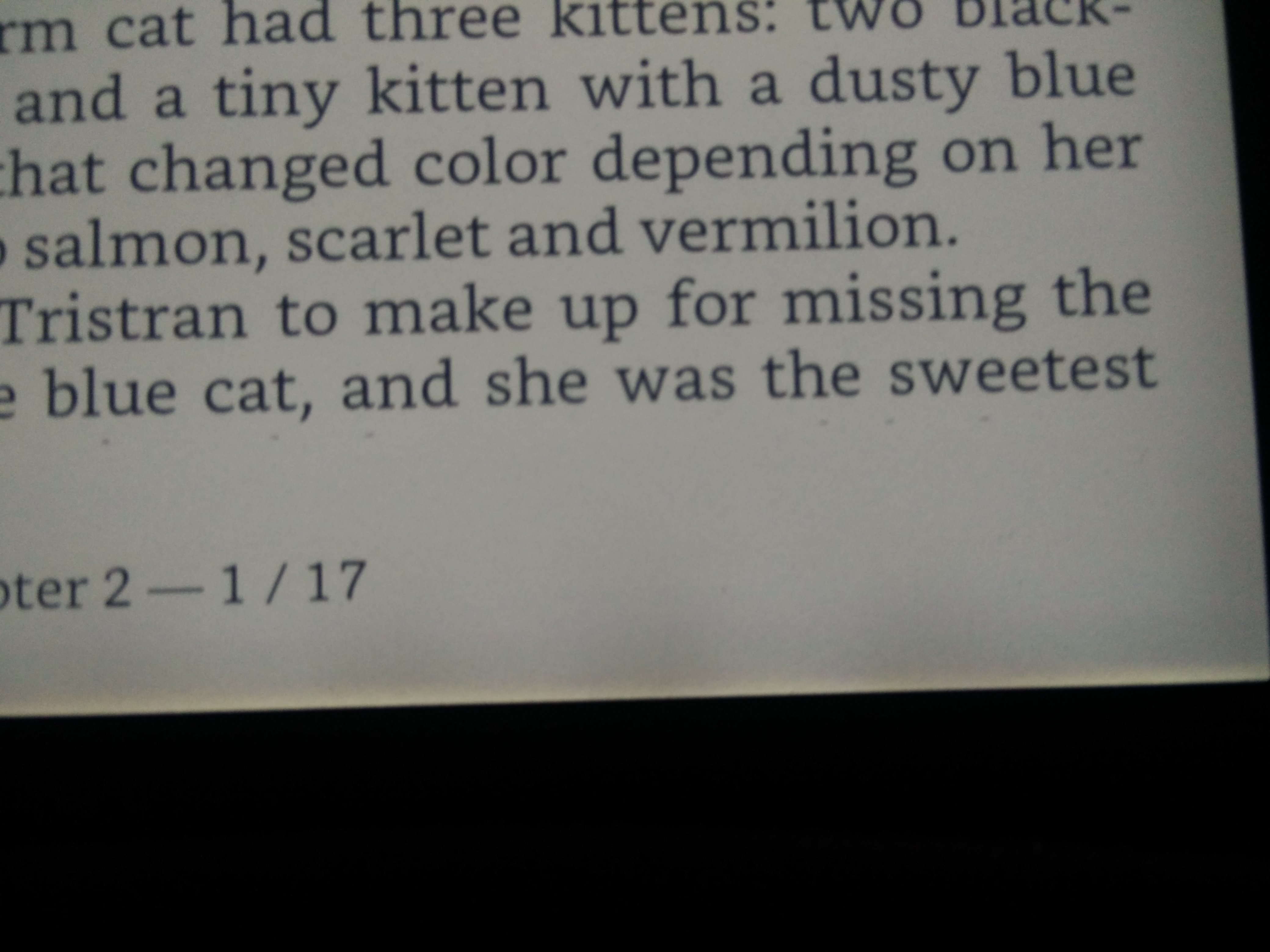

Hi guys, I have a KA1 and I noticed this strange thing: under the last line my KA1 shows a series of dots. The book is an epub converted in kepub via calibre. There's a way to fix this?
Thanks in advance
ID:	156862   Click image for larger version
