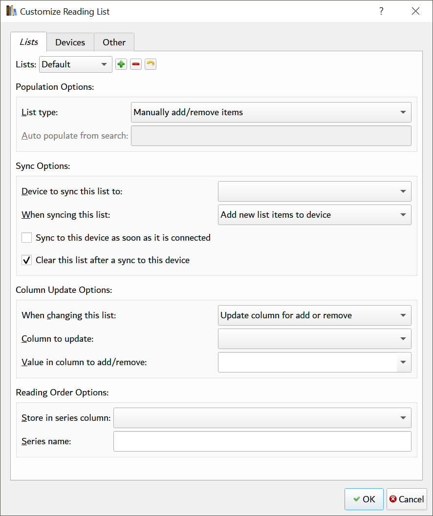

I installed the version that you attached. I removed "Default" list (so two lists remained). Right after it, the menu became reduced but still had expected options (like plus).
I removed another list (so only one list remained). As expected, options like plus disappeared from the menu.
I added one reading list back. The options like plus did not appear! I added the third list - all expected option were back.
So I started removing and adding lists. No luck, the plus appears when there are at least three lists.
In the case of two lists, the plus was there right after the new version was installed.
If there is only one list, Reading List deliberately removes all the sub-menu options that exist for not-default lists.
Shall it remove also Move to list ... option?

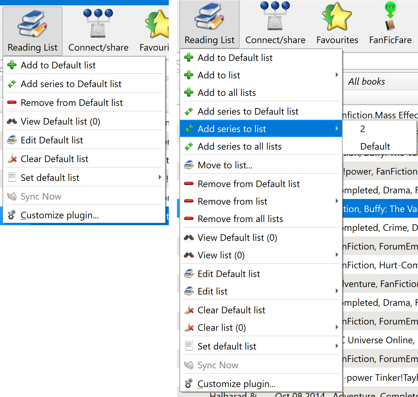

The ReadingList menu only has two states--when there's only one list and where there's more than one. I assume the more-than-one state is what you mean by 'plus options':
You seem to be suggesting that you are sometimes seeing a third state between the two when there's 2 lists?
If so, can you show me some screen captures of what it looks like and, ideally, a Calibre debug log from when it happens? Calibre->Preferences dropdown->Run in debug
(The debug log also tells me about your OS & calibre versions, etc.)
Minor point, but sure; that's easy. Already added in my code, so it's already hidden in the screen cap above.

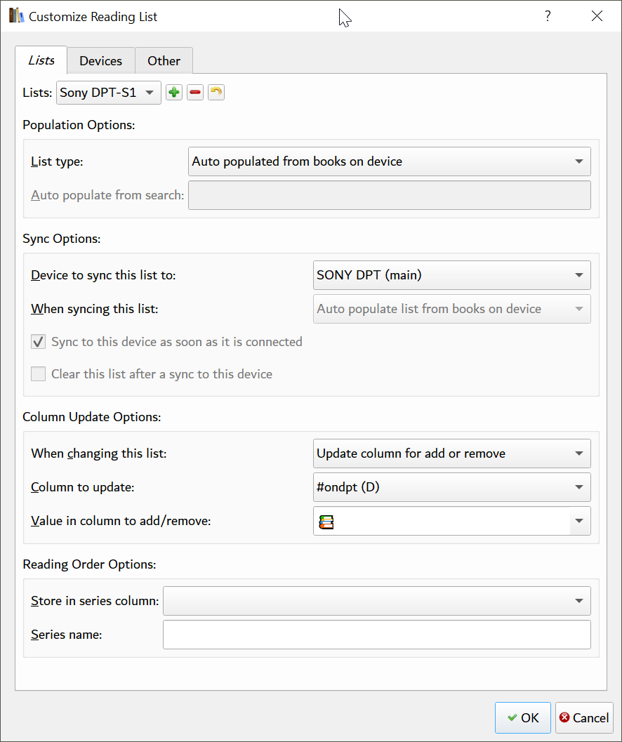

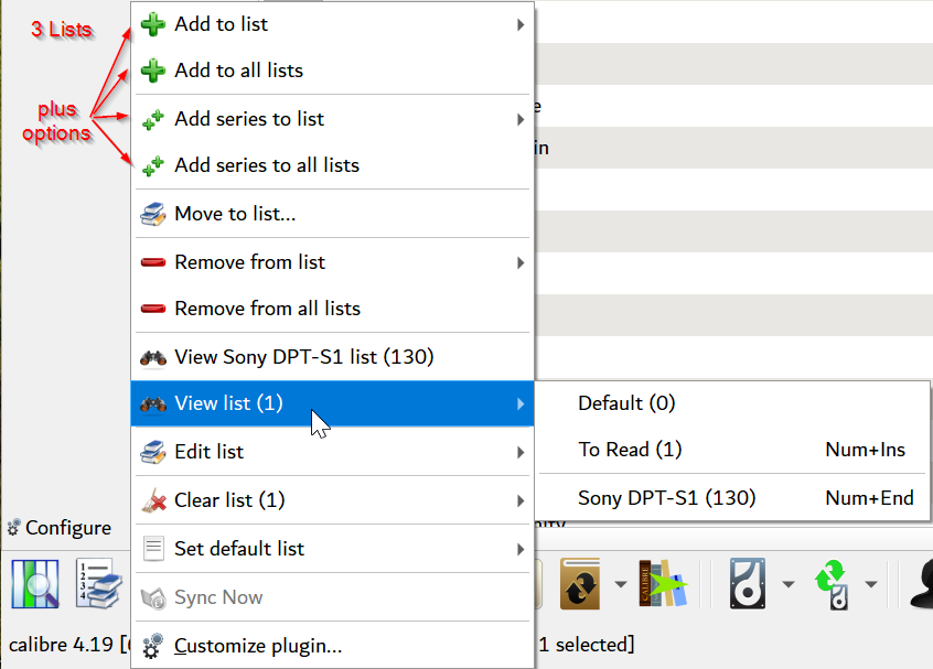

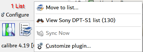

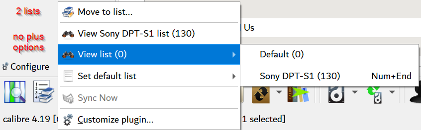

See the attached screenshots and the log files.
  • case of 3 lists (plus options are displayed)
  • case of 2 lists - Default and Sony DPT-S1 (no plus options)
  • case of 1 list - Sony DPT-S1 (no plus options)
  • Calibre debug log

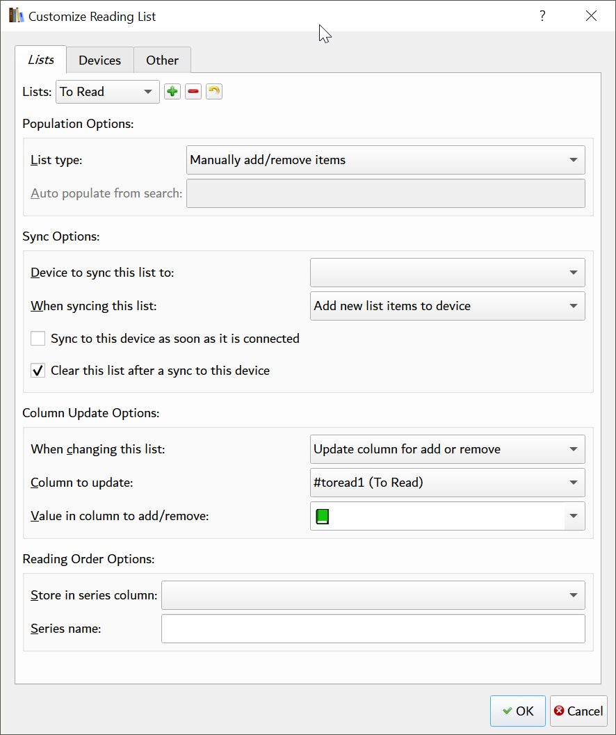

  • all 3 lists properties

Name:	3 lists.png
ID:	180454   Click image for larger version
Name:	2 lists.png
ID:	180455   Click image for larger version
ID:	180456   Click image for larger version
Name:	Default List Props.png
ID:	180458   Click image for larger version
Name:	Sony DPT-S1 List Props.png
ID:	180459   Click image for larger version
Name:	To Read List Props.png

Okay, now I understand this.
Your "Sony DPT-S1" list is set to "Auto populated from books on device"--which means you can't manually add or remove books from that list.
So RL doesn't offer you add/remove etc options for that list, which leaves only the 'default' list, so no need for the sub menus.
As for when it doesn't offer "Add/Remove default" list either, "Sony DPT-S1" was set the default list and it can't have manual add/remove. Set the other list as default that they should come back. (When you delete the default list, RL just makes the first remaining list default.)
So while a bit non-intuitive maybe, I don't see anything broken here.
Thank you for including the captures of the different lists' settings. I didn't think to ask for them, but that's where I needed to look. I've never used the auto-pop list settings and forgot they even exist.

New Test Version
- Allow auto-pop lists to be default all the time and handle them better.
Thinking about this some more, I realized something I should have yesterday: There is something broken, namely that you can't add/remove from that last non-auto list while the last auto list is the default.
(And that the next 'default' list was chosen at random when the current default was deleted.)
The attached version allows auto-pop lists to be explicitly set as default and, I believe, correctly rebuilds the menus in all cases now. Also, when the current default list is deleted, the new default list is chosen alphabetically first from the remaining manual lists, then auto-pop lists to more closely minor past behavior.
