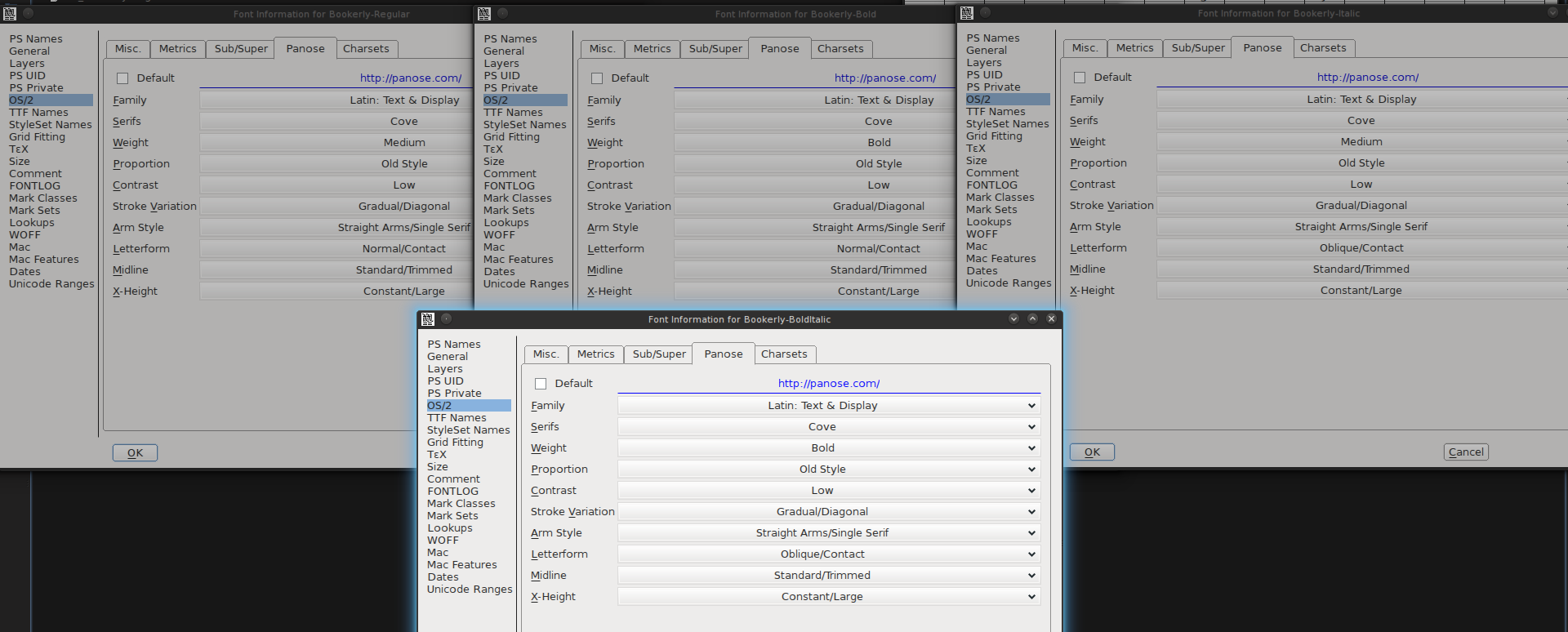

Originally Posted by Cex View Post
Hello,
I tried your script with Bookerly font for eInk devices (extracted from PW2 firmware), but I can't get rid of the Italics problem described in this thread:
https://www.mobileread.com/forums/sho...d.php?t=262943.
I have also tried to correct metadata manually, but can't find any error in the fonts. I have also tried all possible font names with same results.
I'm using sideloaded epubs (have not tested with kepubs) on Glo HD, and I always get italic as bold-italic.
Could someone provide some guidelines to correct this issue?
Thank you.
Sounds to me like it could be a PANOSE issue. Did you choose to strip this information when you generated the font?
EDIT: Dod you restart your Kobo after adding the fonts to the reader?
Stop using the LCD version of Bookerly and pull the eInk version out of the Kindle firmware. I can confirm that the eInk version works no issue and no need to Koboify.
Jon... Jon... Jon....
Do we need to test your reading comprehension skills? What part of "extracted from PW2 firmware" do you not understand?
I restarted every time I tested a change, but I have not tried to remove PANOSE.
Will check later and come back with the results...
